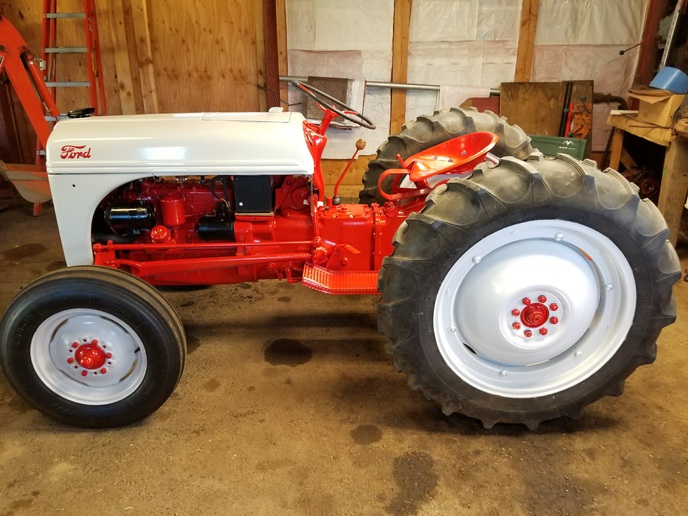

PostPosted: Wed Dec 06, 2017 6:03 pm    Post subject: Re: Air cleaner related starting issues Reply to specific post Reply with quote
Psucivil wrote:
(quoted from post at 18:55:27 12/06/17)
Haha I'm betting it's a different tractor as I'm in Pennsylvania
Did yours look as good as this?

PostPosted: Wed Dec 06, 2017 7:41 pm    Post subject: Re: Air cleaner related starting issues Reply to specific post Reply with quote
Hey, nashranch, That`s one good looking tractor!!

PostPosted: Wed Dec 06, 2017 8:14 pm    Post subject: Re: Air cleaner related starting issues Reply to specific post Reply with quote
TomT wrote:
(quoted from post at 20:41:47 12/06/17) Hey, nashranch, That`s one good looking tractor!!
Thank you Mr T... it was a fun resto and it Sold quickly
