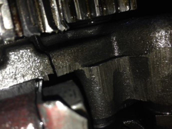

We have a Perkins 23C diesel that freezes up after warm up. The engine was rebuilt a year earlier and ran like a champ. It out performed an
MF250 and JD 1530 after the rebuild. I was told it could pull a trailer of 125 bales of hay up hill in high gear without hesitation. I was asked to
change the oil in it and after doing so the engine locked up after about 5mins. I noticed a little white smoke coming from around the front of the
engine around where the breather tube outlet is after it locked up. About like cigarette smoke. I was involved in the rebuild which was a major
undertaking for me and was sick to my stomach when it locked up. The tractor sat all through the spring and summer as I had other obligations
and until recently out of curiosity I tried to turn it over again. To my surprise it did but you could hear metal on metal. I have pulled it back in the
shop to break it down again but thought I would post this to maybe see if anyone had any advice what to look for. I am hoping it could be
something I could inspect/repair without removing the engine again.

It could be several things. Oil pump not working. Rod Insert spun. etc. How long did it run after rebuild? What oil did you run? Don't think oil change had anything to do with it unless you didn't add new oil. Had a neighbor to do that. Didn't put drain plug back poured oil in ran on ground. He didn't see it.

You got a bearing, or a piston that gets tight when it gets some heat in it. I'd drop the oil pan, and have a look around.

Thanks everyone. I’ll start by dropping the oil pan and see what I can see. I’ll keep you posted.

Looks like oil pump failure.

Axtell wrote:
(quoted from post at 10:21:57 12/18/17) Looks like oil pump failure.
That will do it, never see that happen with that gear.

PostPosted: Mon Dec 18, 2017 4:26 pm    Post subject: Re: MF35 Siezes After Warm up Reply to specific post Reply with quote
Very strange. A few more pics....

Break that ear off the rest of way, and look at the cross section of the crack (see if it looks like a fresh crack, or a old crack).

It has been several years since I preformed a Total R/R on a Perkins....is there a Counter Bore on the FRONT BRG.CAP to accept the protrusion of the oil Pump?
Is a counter bore required in Brg.Cap?
The last pump I installed was an Original from England and the pump mounting flange did not break off:
Bob....Owner operator MF FE 35 X 3 cylinder Perkins:

CVPost-John Deere D wrote:
(quoted from post at 13:21:46 12/19/17) It has been several years since I preformed a Total R/R on a Perkins....is there a Counter Bore on the FRONT BRG.CAP to accept the protrusion of the oil Pump?
Hmmmm.... that is very interesting. I will check that out this morning and update. Thanks!
