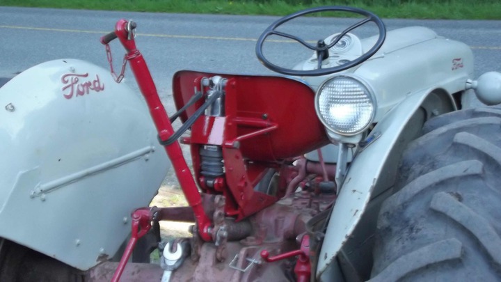

I can keep my 8n in good running condition but never having farme I don?t know how to properly hook up implements. I have my 6ftrear blade on and have the top link hooked to the pin that?s attached to the large spring. I believe that?s ok . Under this pin their are two places to attach things cast into and part of the rear end, the driver side hole about an inch in diameter while the passenger side attachment is slightly smaller about 7/8 ? in diameter. What are these cast eyes used for and why the different sizes. Thanks in advance.

These holes for the long pin?

When it comes time to actually go hook it up, the correct method is to back squarely up to the implement so that the ball at the end of the left lift arm goes onto the left pin of the implement. You then, still in the seat, adjust the right arm for proper height and back up or pull ahead to nudge the right ball onto the pin of the implement. Now you dismount and insert the Lynch pins to hold the two lift arms on, and then attach the PTO shaft if the implement has one. Finally you attach the top link and adjust for correct length. If you would like to see this done, search on U-tube for Ford Jubilee tractor and an original Ford advertising video should come up that shows this procedure.

One part I found interesting and find handy about hooking up was that the farmer rocks the tractor by grabbing a tire lug, to get a stubborn eyeball onto the pin.

As Royse said the long pin. Even after the long pin was gone the housing case carried the ears with the holes thru the Jub/NAA. The ears were a good support for the horseshoe style swinging drawbar. I see a lot of guys hang there limiter chains for there mowers off them.

As others have said, the holes are for the long pin.
In addition to what showcrop said about hooking up implements, it helps to have the implement a foot or so off the ground. Use cinderblocks or pallets.
Lower the lift arms and turn the pto OFF before you get behind the tractor.

That long pin is made with the head end bigger to keep you from trying to put it in backward as only supposed to go in one way and it bends in the middle. It is used for the rear mount manure loader.

Pixer,
About those two cast eyelets . . .
As Kirk showed, height limiter chains can be hung from them
which are especially useful if you have slow hydraulic leak down especially even while the pump is running.
I made some chains for my rotary cutter to hang from and I hook them to big shackles I put in those eyelets.
The chains go down to the lower link pins
I also use one of those shackles to hang my rear blade adjusting wrench in. It doesn't fall out.
