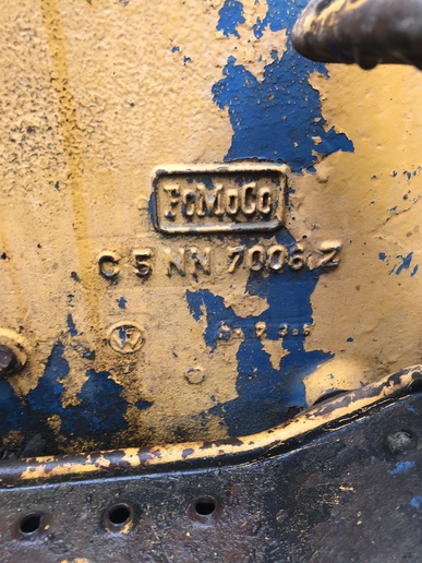

Got the number for this old tractor. If anyone can let me know what kind of tractor I have based on these numbers that would be swell.

here are a few numbers. Can anyone tell me what kind I have based on the numbers on the photos below?

PostPosted: Thu Dec 28, 2017 5:37 pm    Post subject: Re: Please help identify the year Ford 3000 gasser.. Reply to specific post Reply with quote
http://www.springfieldbiz.com/oaktree/codes_short2.html

PostPosted: Thu Dec 28, 2017 7:08 pm    Post subject: Re: Please help identify the year Ford 3000 gasser.. Reply to specific post Reply with quote
GOT IT!
Thanks for the help!
1965 - 1968 Utility Tractor with PTO and 8 speed tranny
It is a 3400 with a 4.2 bore. There were a few years where the cylinder bore was 4.4 but I put a caliper on mine this morning and it is a 4.2
Utility means a beefier front end and bigger loader.
The head goes on tomorrow!

PostPosted: Thu Dec 28, 2017 7:45 pm    Post subject: Re: Please help identify the year Ford 3000 gasser.. Reply to specific post Reply with quote
66 model serial numbers started at 124200
67 model serial numbers started at 161300
Your serial number of 143174 makes it a mid year 66 model
The letter C is for a US made tractor.

PostPosted: Fri Dec 29, 2017 7:29 pm    Post subject: Re: Please help identify the year Ford 3000 gasser.. Reply to specific post Reply with quote
greymond wrote:
(quoted from post at 23:08:55 12/28/17) GOT IT!
The 3400 is the utility model in the 3000 series. All tractors in the 3000 series used the same engines. They were all 4.2 inch bore. The gasoline engines have a 3.8 inch stroke for 158 cubic inches, and the diesels have a 4.2 inch stroke for 178 cubic inches.

PostPosted: Mon Jan 01, 2018 8:08 pm    Post subject: Re: Please help identify the year Ford 3000 gasser.. Reply to specific post Reply with quote
yup, you are correct. 4.4 bore in the 4000's 4.2 in the 3000's
I was on the phone with a parts guy telling me to make sure and measure the bore because it could possibly be a 4.4. Which is incorrect I have come to learn.
