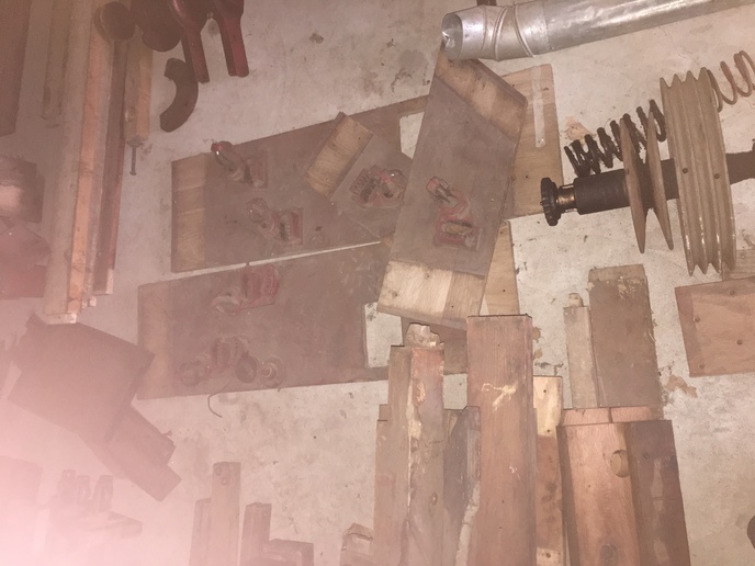

I've sniffed out and bought several larger grain cleaners to replace my 47b I built last year. The demand for on-farm seed cleaning was a fair bit beyond my expectations, so I'm getting a bigger machine to get done faster. This one I bought sight unseen from Montana and didn't realize it didn't have top air, so I'm gonna sell it. It's a super 29a. I also have 2 29ds. One of which will hopefully be my machine for this year. Otherwise, I found another cleaner in Missouri I want to go after to see if it's what I want. Probably head out the 15th of February for that one.
I'm also trying to figure out if I should keep looking for the type of trailer I have in my head, or just build it. I want about 4 feet of enclosed storage at the front, 4 feet of open area below a surge bin to be able to change screens, 12 feet for the cleaner, and 6 feet out the back for a bagging area and a scale. It has to be a gooseneck, deck between the wheels, and no beavertail. I'm pessimistic that I'll find one.
Here's last year's machine on a job. It will be for sale when my new one is ready -

Lots of them were burnt and the metal fished outta the ashes until recently. In fact, the guy from Montana said he was gonna burn his, but decided to try putting it on CL first. I and it got lucky. The guy from Missouri said he almost burnt his, too, but thought he'd try selling it first. The 47b I bought and rebuilt was definitely ready to be burnt when I bought it. It was literally a pile of rotten boards. I got it out of Nebraska.
I was consistently getting 65bu/hr up to 125 bu/hr out of the 47b, depending on the cleanliness of the grain. Dirty stuff obviously took more time through and made a poorer sample. The bigger machines should do a fair bit better - 175-225bu/hr. I get much bigger screens, top air, one more sieve screen, and a second shoe. These should also make a cleaner sample as well.

Here's a few photos from removing a cleaner out of an old mill in Rice Lake, WI that is being converted to a brewpub. We got there about 7 am and were gone by about 1 pm. The machine was on the second story and needed to be taken apart and lowered through the hole. We'll be working on this one last. The next one came from Western Kansas and is in much smaller pieces. (last pic)

I don't think there are many AC72s around to do that to. That, and they're collectable enough that I would hate to do such a thing. I've been very careful not to spend too much on these Clippers so I can sell them off after cleaning them up for a small profit.
Funny thing, two years ago I didn't know a single thing about them. They're very interesting machines. Lots of parts are still available from AT Ferrell new, or used from Commodity Traders. Most manuals and parts catalogs are free on Ferrell's website.
