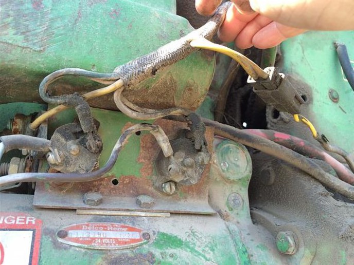

PostPosted: Sat Jan 13, 2018 7:46 pm    Post subject: JD 3020 24volt light/short question Reply to specific post Reply with quote
I completed installation of a new 12 volt battery, hooked the 2 12volts in series (right battery negative to left battery positive) and established a positive ground off the left battery. Vola, the lights worked..until I started the tractor. I did some reading and polarized the generator by momentarily connecting the batt to arm/gen contacts on the regulator. No dice. Volt meter show -24volts at the regulator and starter. Is this reverse polarity normal? The gen light also has come on, with the key off, when the positive ground is attached. It goes out when I disconnect the positive ground, so I think there must be a short in the system?
Any advice, other than 12volt conversion?
Thanks again!

Sounds like you MAY have blown the small jumper wire to chassis ground at the midpoint of the series-connected 12 Volt batteries.
This (oddball) to most system really isn't that tough to troubleshoot or repair if you read up on it and DON'T listen to statements like "The starter was the only thing that saw 24 volt power. ", or "If you have your batteries hooked in series they are not wired correctly." or " My understanding of the fuse is that it will protect the lights from blowing from the 24volt load in case of a short?" you'll get it fixed!
The main difference between the early and late diagrams is that the early system used the cast iron chassis as the common/crossover connection between the series-connected 12 Volt batteries, and the later system used an actual battery cable to join the two series-connected 12 Volt batteries, with a jumper wire or fused jumper wire joining the midpoint of the series-connected batteries to chassis "ground".
From the point of view of the starter, generator, and voltage regulator it's a 24 Volt system created by connection two 12 Volt batteries in series.
From the point of view of the fuel gauge and lights, half of the load is fed from what's effectively a (+) grounded 12 Volt system, and half from a (-) grounded 12 Volt system.
Pay attention here...
The large stud (highest up) on the stater solenoid should read (-) 12 Volts (nominal) with respect to the chassis.
Stud on the engine block side of the starter belly" should read (+) 12 Volts (nominal).
The "BATT" terminal on the voltage regulator (blue wire) (-) 12 Volts to chassis, and the A2 terminal (brown wire) at the generator (+) Volts.
If you want help, check the voltages at those points and post back.

PostPosted: Sun Jan 14, 2018 3:44 am    Post subject: Re: JD 3020 24volt light/short question Reply to specific post Reply with quote
bstover
If small ground wire isn't completing connection from rear LH battery post to frame then gen light shouldn't be "on" as it should have no 12 volt ground without small wire making connections. If generator light is on when ign switch is off something is back feeding gen light which is probably the volt regulator at fault.
What do you imply when you state "you have no fire insurance"?? Does this 24 volt system have the circuit breaker kit(AR47675) installed(see photo below)? If CB kit isn't installed then 24 volt system is more subject to catch fire from bad wiring insulation.

PostPosted: Sun Jan 14, 2018 6:24 am    Post subject: Re: JD 3020 24volt light/short question Reply to specific post Reply with quote
One common problem on these awful systems designed by AC Delco is the starter-motor loses its isolation and provides a path to chassis-ground. Sometimes all it takes to fix is to take the starter apart and blow all the brush-dust out of it. I never understood why Deere did not use the 24 volt system like used in the 1010s instead.

PostPosted: Sun Jan 14, 2018 9:17 am    Post subject: Re: JD 3020 24volt light/short question Reply to specific post Reply with quote
Bob,
I've rewired the batteries as per the black and white diagram posted. I've obtained all the correct voltages in the proper locations.
The generator light is on, even with the ignition off, and the lights are not working. The generator light goes out when I disconnect the 12volt negative terminal to the starter body. I'm thinking the short is in this circuit?
I'm going to clean the starter post, just trying to figure out how to get the 3rd bolt out of the starter.
