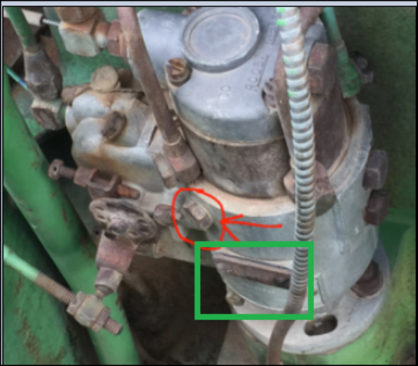

I am having what I think is a fuel delivery problem on my 3010. We were using it to drill some post holes, when it started losing RPM until it stopped. Worked with it a little and thought it was the fuel pump. Replaced the fuel pump and still get the same thing. We can get it started, but it will not respond to the throttle, then just loses RPM until it dies, then won't start. There is fuel pressure to the injectors and pressure in the injector pump. We checked the fuel return line that runs from the injector pump to the injector, then on to the fuel tank and it seems to be open.

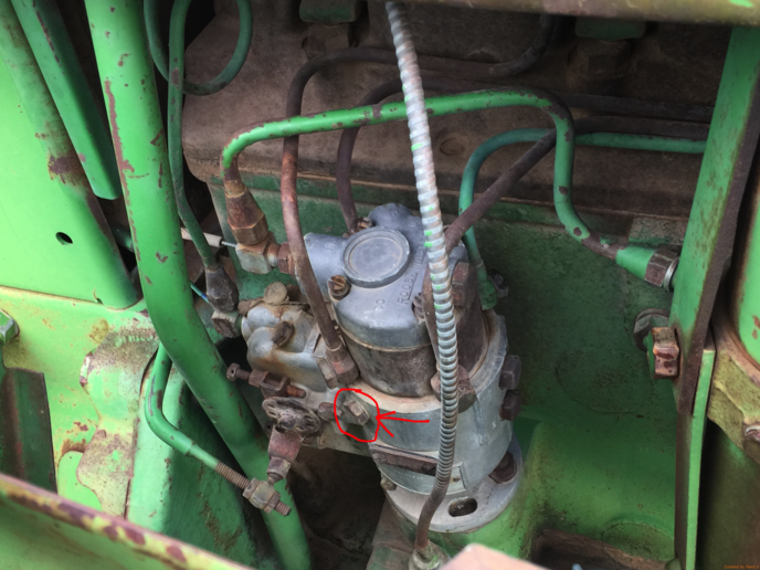

We found that if we loosen a particular cap screw on the injector pump, the release of pressure seems to allow the fuel to flow, then the tractor will run, but not well, while fuel is spurting out from the loose capscrew. The screw is one of the two that are safety-wired on the parts diagram. I have indicated it in the attached photo.
Any ideas?

You are loosening a bolt that secures the head and rotor to the pump body, relieving housing pressure, and allowing the pumping plungers to take on a charge of fuel and pump it to the injectors..
Must likely, the plastic governor damper ring inside the IP has disintegrated into what looks like coffee grounds and has plugged the return fitting where the lower of the two lines in your photo is connected.
Disconnect the line and remove the fitting and report back with what you find in it.
SHORT version id that the IP needs and overhaul.

Yes, but if run too long two parts in the governor normally separated by the plastic disc begin to rattle against each other, putting steel particles in the guts of the IP, and eventually wearing off three drive pins that can cause the governor to malfunction and the engine to destructively overspeed.

Ditto what Bob stated. To verify you can loosen the 2 screws on timing window outlined in green rectangle,pry gasket loose from pump body,start engine & if engine operates correctly check valve or return line is clogged.

Remove the return elbow fitting from the pump, then remove the ball and spring from the elbow,,(file the edge of the fitting a bit to get the washer to release)discard the spring ,washer and ball reinstall and finish your work,, schedule a pump rebuild in the near future,,
