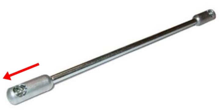

One question I have right now is it looks like the rod that comes forward from the carb the arm that runs down and goes in the side by the crank will need to come off. I don't find any cotter pins or anything holding it in place, does this just pry off? I don't want to get forceful and break it.
The rod has a spring loaded cap, just push away from the rod to remove it from the ball on the throttle arm.
