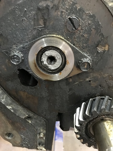

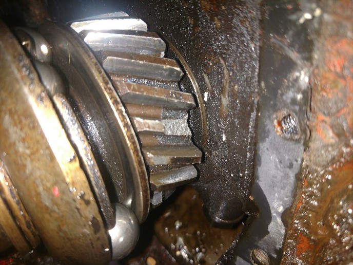

Bad news. I got the cover off the timing gear finally. Shattered gear. Worse news, there is a crack in the cam shaft at the back of the woodruff key slot that goes back to the cam bearing. Plus broke the cam bearing thrust plate (?) And front of woodruff key slot has two cracks, small piece of metal I can move by hand.
Looking like this old girl might be in for a total overhaul since the cam shaft probably needs replaced.

Pictures must be too big I resized now they seem to work...
My initial disgust...
Broken thrust plate (?)
Gear removed
Thrust plate remove, two cracks at front of woodruff slot, one at back goes back towards cam bearing
Missing a couple teeth on crankshaft

PostPosted: Sat Jun 23, 2018 10:22 am    Post subject: Re: 1954 Ford NAA Jubilee died need help Reply to specific post Reply with quote
Where are you located rininger85?
I have a NAA engine that was running but had a bad crank so it
knocked badly. Crank, pistons and head have been removed but
the camshaft and gears are still in it. I haven't inspected them yet,
but if you're close to me I could pull them and see if they'd work
for you. I'm in Michigan.

PostPosted: Sat Jun 23, 2018 1:32 pm    Post subject: Re: 1954 Ford NAA Jubilee died need help Reply to specific post Reply with quote
Royse I'm in Eaton Rapids / Charlotte area, just south of Lansing so I'm probably within an hour of Ionia. If you can take a look and see if they are still in good shape I'd gladly work something out to come buy them from you.
I am a little I'll equipped to work on this sort of stuff at home. It took me this long because I was worried about doing something stupid and getting hurt since I don't have proper equipment to use for lifting this old girl... Just about lost her off the jack today when I was trying to put the axle back on for safety once I got the pull I needed off the front. Got her blocked up better now so hopefully won't have that issue again. Pulled the fuel tank off so I can get to the top of the engine and have the oil pan off. Looks good other than the front of the cam issues from what I'm seeing.
Is there a way to remove the cam without completely breaking the engine down or do I need to pull the crank to get the cam out? Easiest to just pull the engine out and work on a bench?

PostPosted: Wed Jun 27, 2018 3:42 pm    Post subject: Re: 1954 Ford NAA Jubilee died need help Reply to specific post Reply with quote
Well, it was a good thought, and it might have been good since the
block still had oil and antifreeze in it, but I broke it pulling the gear.

PostPosted: Sat Jul 07, 2018 12:25 pm    Post subject: Re: 1954 Ford NAA Jubilee died need help Reply to specific post Reply with quote
Oops! Oh well, we can get one elsewhere. Is that thrust plate still in good shape that I could buy that off you? My dad is finding gears and a cam we can get online but not finding the thrust plate.

PostPosted: Fri Jul 13, 2018 2:17 am    Post subject: Re: 1954 Ford NAA Jubilee died need help Reply to specific post Reply with quote
I've got a cam and both cam and crank gears here now. All I need now is the thrust plate. I'll send you a PM.
