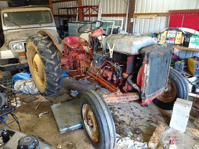

just some pics I had on my phone of the old girl in various stages of undressing.

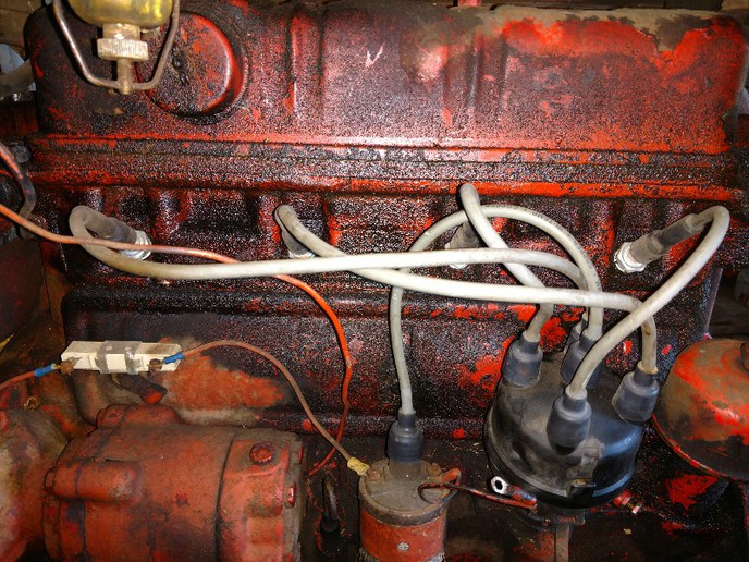

I took pics of wires as I pulled them to try to remember what goes where on the distributor =)

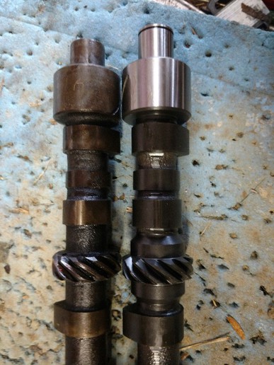

The new cam shaft is slightly different, the old one the gear was held on with a washer and bolt, the new one is a tight fit and has a groove on the end I'm assuming for a retaining clip. The new is a little longer, but probably no longer once you add the washer and bolt, so hopefully it's still going to work.

Oops it posted one of the pics twice and didn't post the third pic I tried uploading but it was another of the cam. The oil pump gear is not quite as wide on the new cam either but hopefully it's not an issue.

I hope not... I don't want to replace anything else on this thing. We have started putting it back together... Cam lifters are back in place, new cam shaft is in. Need to go get bolts for the hydraulic gear to bolt onto the cam... Which by the way I don't know if I mentioned it but the gear was missing a tooth when I got it out, which didn't matter since the new cam shaft doesn't match the old cam shaft we had to buy a new hydraulic gear anyways... Once I get bolts tonight I can put that fear back on and be on my way.
We replaced the clutch plate and retainer since the engine was split off, and put a new bearing on the back shaft but not messing with the smaller bearing which I assume goes in the block (unless there is something I haven't come across yet...not messing with the crank so not replacing that bearing if it is for the rear of the block).
Have cam shaft retainer back in place. A few bolts and we should be able to put the two halves back together.

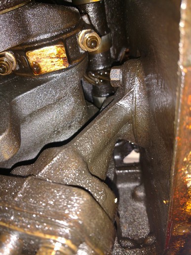

Found another broken part... The alternator mounting bracket was broke some time ago because it was full of grease and grime in the crack. So we could put it back together how it was but I'm going to order a new mounting bracket they are cheap.
