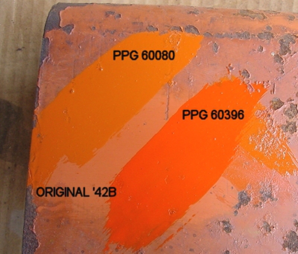

[quote="CVPost-D beatty"](quoted from post at 01:31:09 01/27/1Cool Are you saying its not correct paint and decals. If it was then most of the WD45s were painted the wrong color at the Gathering of The Orange 2015.
Not sure who you are referring to by your question. I see a couple different shades of orange in the pictures. The sun and aging makes some difference. Different brands of paint are NOT the correct color, even tho they may claim to be P.O.#1. I use PPG and feel it is about as good as it gets for correctness. I can't tell the decal colors, but the big A and S are to be blue. The small A and S are always black. The year of change from blue to black was sometime in 1950 or 51 I think. A "WD" never had a WD decal if decals were blue. That's how it was when they were built. It's a free country (yet) and anyone can paint and decal their tractor however they want. I just figure spend the same $$$$$ and get the correct paint/decals. Resale value down the road just might be better.

PostPosted: Sat Jan 27, 2018 5:25 am    Post subject: Re: Painting a WD Reply to specific post Reply with quote
Yes is is s free country but those that mock restoring tractors properly make no sense.
Rod(NH) was kind enough to post the difference in another thread .

PostPosted: Sat Jan 27, 2018 5:27 am    Post subject: Re: Painting a WD Reply to specific post Reply with quote
the PPG 60080 is #1 Persian Orange

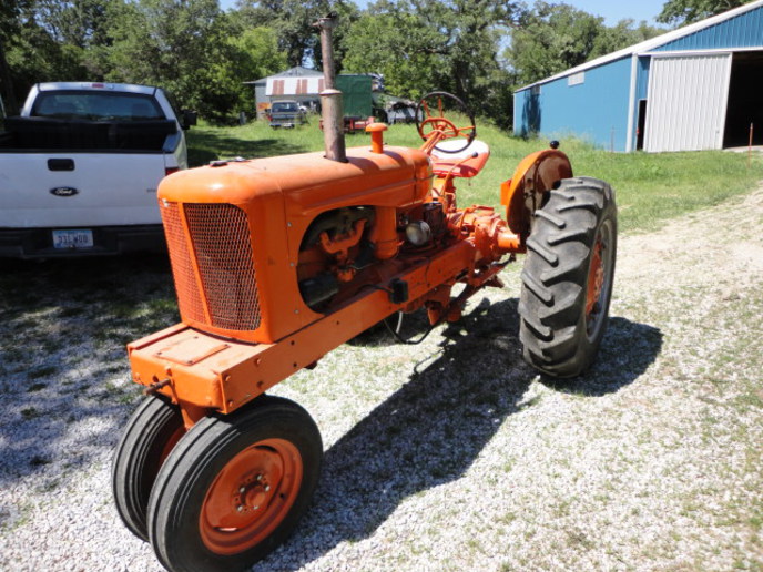

PostPosted: Sun Jan 28, 2018 7:11 am    Post subject: Re: Painting a WD Reply to specific post Reply with quote
This is a 52 WD that is said to have been in same family since new and never been repainted.

PostPosted: Sun Jan 28, 2018 7:43 am    Post subject: Re: Painting a WD Reply to specific post Reply with quote
Looks pretty legit to me. Small "A" and "S" that were black and then the "WD" designation. I don't think one will ever find a serial number break in the parts book as to when they went from old blue decals to these the newer ones.
