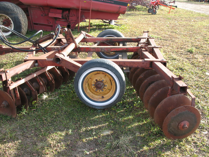

PostPosted: Thu Feb 08, 2018 8:39 pm    Post subject: Re: How much drawbar HP would it take to pull a 10ft wheel d Reply to specific post Reply with quote
CVPost-RJKeith wrote:
(quoted from post at 06:23:36 02/01/18) I have a 13 ft I pull with a Case 800, 55HP.
good evening RJKeith, looking at the top pic of your tandem disc the pipe swivel that raises and lowers your wheels is missing 3 grease nipples that screw into the top brackets that hold the pipe in place on the frame I think, I have the same set up on my mm 10ft. disc and your looks like a Krause design like mine.
