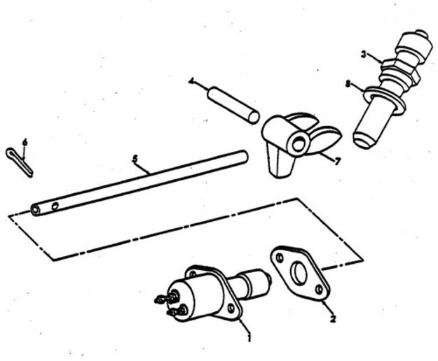

" Just to clarify the silver round object with wires is a starter switch?"
Yes. It's not a solenoid.
" Is the button with the rod obsolete with the engine change to a newer year?"
Well, if you want to start the tractor from now on by jumping the starter switch with a screwdriver you could forget about the push button..........
Did you miss my first reply to you? I said " When you press the starter switch, it pushes a piece of linkage into the switch which manually closes the contacts and completes the circuit. Unlike a solenoid which electrically closes the contacts and completes the circuit. "

"Is the button with the rod obsolete with the engine change to a newer year?
No the button and rod should contact the back of the starter switch. Those switches do go bad. Remove it and test it.
Your start mechanism should have all of the parts in this photo:
