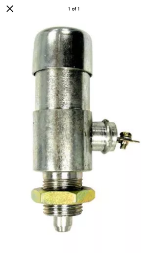

Starter button is a rod not wires.

I was told the button you push to start the tractor would have wires which may need to be checked. I took the button off and it was a rod not wires.

I take it you mean the rod at the bottom of this button. If so that Rod disables you from starting the tractor When the tranny is in gear. Needs to be in neutral. If you look at the side of that button there’s a small screw. A wire needs to be attached to that screw and back to you solenoid. If the tractor is in neutral you’re allowed to press the button therefor grounding the solenoid and spinning the starter

Following thread has a nice write up about a 9N starter switch and the mechanics around it.
http://forums.yesterdaystractors.com/viewtopic.php?t=954029

2 and 9N?s did not come from the factory with solenoids. They all had mechanical starter switches. When you press the starter switch, it pushes a piece of linkage into the switch which manually closes the contacts and completes the circuit. Unlike a solenoid which electrically closes the contacts and completes the circuit.

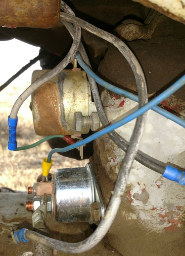

Does your tractor have a three or four speed transmission? That will tell us if you have a 9N or 8N. Also can you post a picture of your
solenoid?

[quote="CVPost-HCooke"](quoted from post at 12:05:03 02/06/1Cool Does your tractor have a three or four speed transmission? That will tell us if you have a 9N or 8N. Also can you post a picture of your
solenoid?[/quote]
I will post a pick when I get home. I has a three speed.

It has a mechanical starter switch. I wonder if they added the solenoid later. It is new.
I will take pictures when I get home.

Sounds like you have a 9N (3 speed trans) with a 1948 8N engine in it. Not a problem and not the first time it's been done. You picture is a
started switch and not a solenoid. The switches go bad. If you need to replace it get a stater switch for a later 9N or 2N. The early 9N
switches wit on the dash and will not work for your tractor.

Just to clarify the silver round object with wires is a starter switch? That is what I am jumping to get it to start (putting a screwdriver across the posts).
Is the button with the rod obsolete with the engine change to a newer year?
