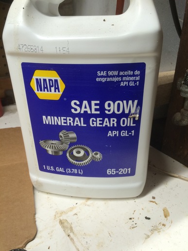

The Gl-1 that you used was what brand and what weight? and where did you purchase it?
email is also open. thanks

PostPosted: Thu Feb 08, 2018 8:43 pm    Post subject: Re: Sherman install Reply to specific post Reply with quote
NAPA has it in quarts, gallons, and 5 gallon buckets - I did a good clean and refurbishment of the trans/hydraulic/rear end two years ago and used this fluid in those reservoirs -

PostPosted: Thu Feb 08, 2018 8:47 pm    Post subject: Re: Sherman install Reply to specific post Reply with quote

PostPosted: Thu Feb 08, 2018 9:01 pm    Post subject: Re: Sherman install Reply to specific post Reply with quote
I,m looking for 140, I checked at Napa about a year ago and was told that 140 was not
available. thanks

PostPosted: Fri Feb 09, 2018 3:55 am    Post subject: Re: Sherman install Reply to specific post Reply with quote
CVPost-el6147 wrote:
I,m looking for 140...
Have you checked with John Deere? I used to get that sort grease there to lubricate the rollers on a 40 crawler

PostPosted: Fri Feb 09, 2018 6:36 am    Post subject: Re: Sherman install Reply to specific post Reply with quote
exactly what I need it for , I think I checked once with John Deere.

PostPosted: Fri Feb 09, 2018 9:02 am    Post subject: Re: Sherman install Reply to specific post Reply with quote
I hear John Deere 'corn head grease' mentioned sometimes as a thick flowable oil for use in places like steering gear boxes where seals have deteriorated and lighter lubricants leak out - -
have you the special gun with fitting that is used for those crawler rollers?

PostPosted: Fri Feb 09, 2018 11:05 am    Post subject: Re: Sherman install Reply to specific post Reply with quote
yes its the Lincoln gun, Would prefer to stay with GL1, that is what I've always used and I
have no leaks. I have located a place that can get it for me in a 5 gal bucket, it's just
that it is about a 120 mile round trip for me. Thanks

PostPosted: Sun Feb 11, 2018 5:58 am    Post subject: Re: Sherman install Reply to specific post Reply with quote
Have you already purchased the oil?
I use 15W40 in my tractor. Doesn't get as thick in cold weather.
