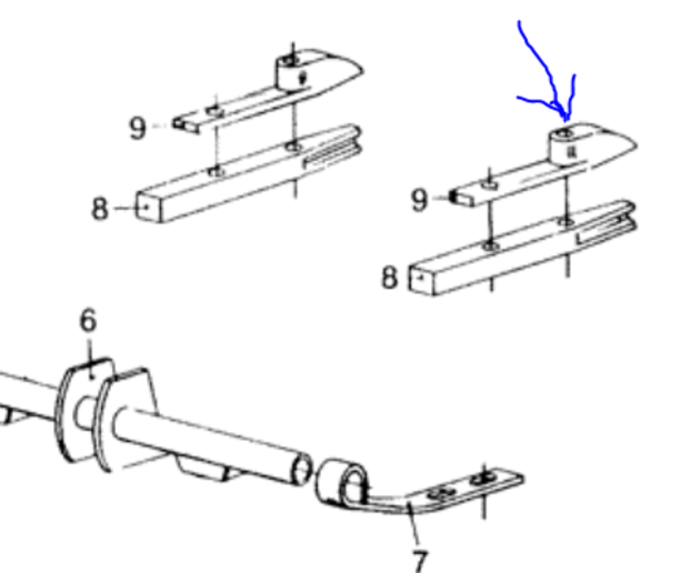

PostPosted: Fri Mar 09, 2018 8:43 am    Post subject: Re: Finding a vid on bailer wire tie mech Reply to specific post Reply with quote
Blue arrow points to gripper pivot bolt hole.

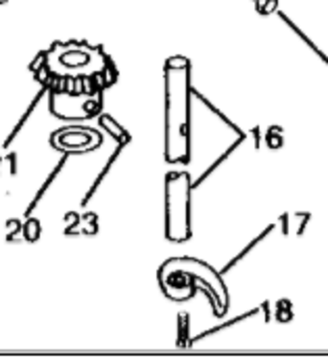

Tx Jim
Tractor Guru
Joined: 14 Feb 1999
Posts: 25870
Location: N Central Texas
Report to Moderator
PostPosted: Fri Mar 09, 2018 9:54 am    Post subject: Re: Finding a vid on bailer wire tie mech Reply to specific post Reply with quote
I couldn't locate the JI Case 140 parts catalog so I posted NH parts but all small sq balers are similar. Key 9 in my photo is the gripper arm that moves from side to side that gripper/knife(key 8) attaches to. Point of twister hook(key 17) should set under hole with blue arrow pointing at it when tying system is in home position

PostPosted: Fri Mar 09, 2018 1:31 pm    Post subject: Re: Finding a vid on bailer wire tie mech Reply to specific post Reply with quote
Don't see a Key 8 or 9, NOR no blue arrow. I have something called an anvil, which I believe grips the wire. What it grips the wire against, I don't know. I may have to take the anvil s out and have them welded in and smoothed out again as they have grooves in them.

PostPosted: Fri Mar 09, 2018 1:50 pm    Post subject: Re: Finding a vid on bailer wire tie mech Reply to specific post Reply with quote
CVPost-Farmallb wrote:
(quoted from post at 16:31:32 03/09/18) Don't see a Key 8 or 9, NOR no blue arrow.
So you can't view the photos I posted Correct?
Back to top
View user's profile
Farmallb
Tractor Expert
Joined: 01 Jan 2008
Posts: 2815
Report to Moderator
PostPosted: Fri Mar 09, 2018 4:35 pm    Post subject: Re: Finding a vid on bailer wire tie mech Reply to specific post Reply with quote
Viewed them perfectly. There was NO #8 OR 9. I didn't see an arrow, blue or otherwise, as all was in black.
