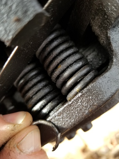

Ok after tearing down the motor to find out what made it stop abruptly then figuring out its in the trans because when i push the clutch in the motor will turn over. I put the motor back together and pushing the clutch in it will start so i could lift the bucket and tow the tractor into my coverall so i can work on it. I can see though the fill hole i have a Multipower issue due to cracking in the Multipower clutch. I don't know thats what stopped it but I know it has to be fixed. I got it split at the gearbox now i have to remove the lift cover so I can get the rear split done.
I found these clip pieces in between the engine/trans. Any ideas?
Also the clutch finger bolts seem to have quite a bit of wear I think?
And is this normal for these to be worn off?

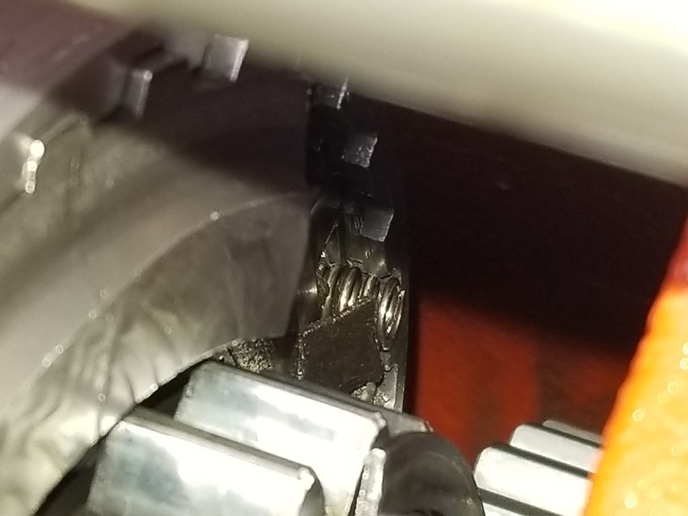

The outer shaft rotates freely in neutral. The inner shaft does not. I assume its connected to my problem.

Clutch bolts show normal wear. Looks like part of a broken coil spring, maybe from the clutch assembly. The transmission needs the shift/steering box removed so the MP supply line can be disconnected before the transmission can be removed from the diff case, for tear down and repair..

It looks like there are some major issues in the clutch unit. I would agree with DT that the wear on the adjusting bolt heads is normal. If the bolts are the same ones as used on UK tractors there cannot be more than a thread or two holding them in the release arms. Ideally they should be in the depth of the arm. Another problem is why have the release arms worn the rivets away? This is normally due to excessive travel of the arms before the PTO clutch plate is released. The cause of this will be down to several possibilities; major wear in the links between the main clutch pressure plate and the outer end of the release arms major play in the pin holes in the clutch cover, wear on the pivot pins or in the release arm pivot points. The height of the bolt face which contacts the release bearing is not critical but all three being the same height is. I would suggest that you investigate this before reassembly.

CVPost-Dieseltech wrote:
(quoted from post at 09:56:18 05/08/1Cool Clutch bolts show normal wear. Looks like part of a broken coil spring, maybe from the clutch assembly. The transmission needs the shift/steering box removed so the MP supply line can be disconnected before the transmission can be removed from the diff case, for tear down and repair..
The part is too small to be the clutch springs. Its about the size of the wire springs but they are intact and appear newish.

The release bolts have normal wear. Reason the PTO disc rivets are worn is due to the release levers traveling too far forward, usually from the PTO release gap being too large, so the pedal clamp on the shaft is then incorrectly set. .080 PTO release gap works well, then if pedal free play is set right, push the pedal SLOWLY while watching the PTO shaft in gear and turning. PTO should stop with pedal about one inch above the step plate, and NEVER start again with pedal clear down. If it does, that's when the release levers are making contact with the disc rivets and turning the disc again. INCREASE the pedal free play will stop the problem. Lift cover DOES NOT have to be removed for MP oil line access for the trans/diff split, line can be removed at the front AFTER the shift cover is off. MP oil line can be removed at either end, depending on what is being repaired..

Got my split completed and found the problem. Which we suspected was the multipower clutch pack. The stress cracks made it fall apart and This big ring was stuck in the gears.
