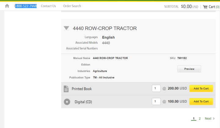

Tx Jim
Tractor Guru
Joined: 14 Feb 1999
Posts: 26312
Report to Moderator
PostPosted: Wed May 16, 2018 4:52 am    Post subject: Re: JD 4440 Powershift Hydraulic Problems Reply to specific post Reply with quote
You could buy a JD 4440 tech manual as it contains a lot of info.
