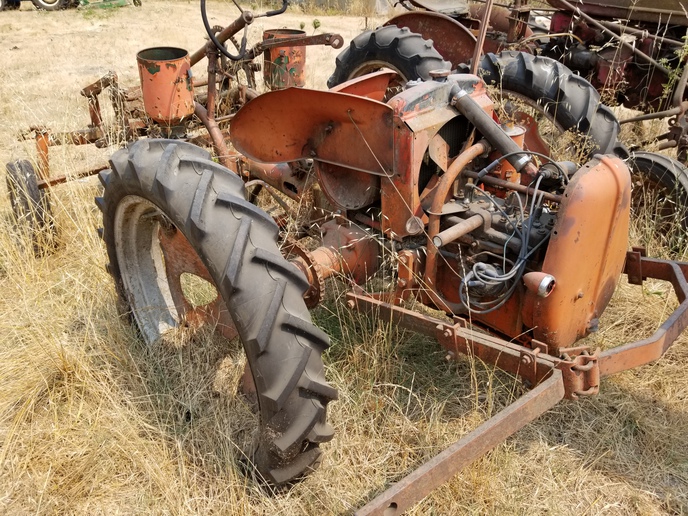

I saw it today...liked it... it's all there...needs battery, plug wires, air cleaner top.
I hooked up battery to the starter and cranked to develop normal oil pressure. All looks good with the crankcase oil. Gas tank was dry and slightly rusty. I'm sure carb was gunked up but rebuildable. It comes double seeder units plus a 4' or so bare with cultivator arms. It needs air in the rears but are good . Air needed in the fronts, one front questionable.
I offered the guy 1000 and he said F**k No so I walked away. I'll let him stew on my offer a while and call him up in a week. And see what he says.
I want to take on the project but not for 1500

After your pictures I would change my mind about the price. If I wanted another I would go the 1500 with the seeder.
Spinning over is a good sign but would be expected with a flat head. That engine without a water pump was used in other tractors and factory mules. When over heated they would loose their compression. When they didn't have a lot of hours the pistons could be taken out the bottom with only removing the pan with new rings would be back running. With luck this could make it hard to start because of low compression. On this one I would remove the head and measure the cylinders for wear If you find it to be low on compression. I found it easier to put the rings on the pistons after they had been pushed up from the bottom.

That planter set up is pretty neat and would make it worth more to me.If I wanted a G I'd probably go the $1500.
