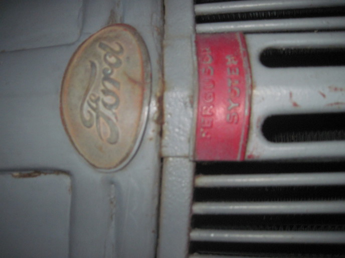

Hello,
I have a 1949 8N. That's what the serial on the engine side tells me. Everything seems to be 8N but the hood and grill. I heard all 8Ns have the Ford script on it. Mine does not. Please look at attached two pictures. Do these help place the hood/grill with a certain tractor? What would be the correct color of these two emblems? thanks for looking.

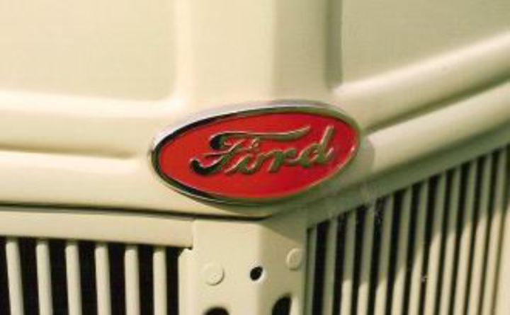

The four slot grill first appeared early in 1942. 8N's were the first with Ford script on the hood above the head lamps.
Emblem colors for 2N:
Early 8N emblem color:

Thanks Dollar Bill. Therefore this is a 2N hood and grill? Why do you suppose that it is on an otherwise 8N?
And, since the Ferguson system on mine is red and looks like the Ford had some red too, someone painted them inappropriately - or was red an option?

Original hood could have rusted out or a tree fell across it??
Not aware of optional emblem colors. They all came off assembly line pretty much the same. Most options were added at the dealership.

Can you post more pictures of the entire tractor? I would posture that you have a 9N or 2N that as had the engine swapped out with an 8N one. The 9N/2N grilles did not pivot out for cleaning of radiator which means the hood and doglegs would be fitted for it as well. I don?t think you have had the hood and doglegs replaced, but more pictures will help determine that. It is only my theory that you have an 8N engine in a 2N tractor. Do you have a 3-speed or a 4-speed transmission? ALL 9N/2N badges were FORD BLUE background and chromed text. The FORD script emblem was on top with the ?FERGUSON SYSTEM? badge below. The FORD 8N badge was Vermillion background and chromed text and introduced the flip-out grille.

your brake pedals, transmission, and position of battery all say 8N.

Tractor is an 8N. Hood is from earlier model. 8N hood has a louvered door with a screen and "funnel" inside to take air into the air cleaner on the side where the air cleaner is. Yours appears to have a decal in that location.

Not to mention the removable brake drums. I agree, 8N with earlier hood.
1948-mid '50 since the generator is on the right hand side w/ front mount
distributor. There may be date codes on cast into the hydraulic pump or rear
axle trumpets that might help narrow it down. But, they are changeable too.
As far as I know, the 8N always had the script on the hood, but not on
the fenders until the later models. The fenders do interchange though.

Well, I'll be. It is an 8N except for the hood, doglegs, and grille. Those pictures are fine for determination. It seems like a lot of work to acquire those parts if replacing unless one already had them at hand and wanted to save some $$$. If they were gotten otherwise, why not just get the correct parts? Ford rear Hat Rims and subsequent aftermarket rims are all 6-LOOP style and will interchange from a 9N/2N to an 8N and beyond. It is the center discs and wheel hubs that differ. The 9N/2N wheel hubs had an inner 6-Bolt Hole pattern on a 11.25" radius and the 8N rear hubs and beyond had an 8-Bolt Hole Pattern on a 6" radius. The rear center discs do not interchange from a 9N/2N to an 8N and beyond. Hat Rims never changed. ALL 9N/2N and early 8N's up to s/n 263844 in April, 1950, had the front mount distributor, so that is NOT an 8N identifier, simply a possible early 8N one. In April 1950, beginning with s/n 263844, the 8N changed to the angle mount (side distributor) revamping and moving the generator to the LH side. At this time the FORD script was added to the fenders. The FORD script on the HOOD was NEVER a 9N/2N feature -it was introduced on the 8N Tractor in July, 1947 from it's initial release, and not in 1950. Another 8N hood identifier is the air cleaner vent on the rear RH side near the dash. 9N/2N hoods never had an air cleaner vent so it is plain stamped steel there. It appears you have an 8N chassis that has had all the sheet metal replaced. The hood, doglegs, and grille coming from a 2N and the fenders coming from a 1950-1952 8N. Congratulations, you have bragging rights to a "MUTT"!!! Fear not, there are many around. The important factors to know are that you have a front mount distributor, a 4-speed tranny, 8N Hydraulics, meaning you also have POSITION CONTROL in addition to the standard DRAFT CONTROL system. I see a Voltage Regulator, ballast resistor, and a 6V battery which means you should also have generator. Just ensure the setup is wired correctly. Seek "WIRING PICTOGRAMS BY JMOR" available for FREE download at the N*T*C* web site under HOW-TO's/ELECTRICAL. You can also go to the now archived website from John Smith -click on the LINK below -and go to the TRACTOR ID/HISTORY page for a ton of useful information.
