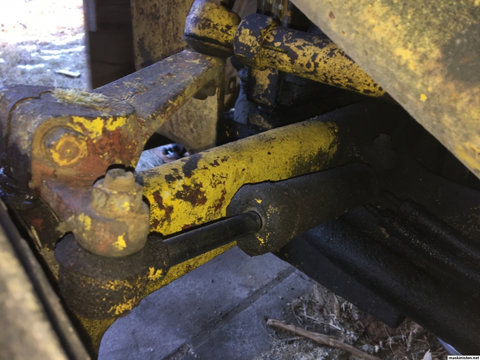

Anyone knows if there is any power steering for FE 35 4cyl? I can find kits for 135 that fit MF 35 3cyl, but is there any for the 4 cyl 35?

Is your sector the one with cylinder attached or the one where rams are used on the arms?

Watched the video but could not tell much. The sector does not look like the type which has cyl mounted on it.

Does anyone know if the power steering from MF702 4cyl fits FE35?

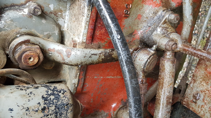

mf35a wrote:
(quoted from post at 15:36:06 09/25/1Cool Anyone knows if there is any power steering for FE 35 4cyl? I can find kits for 135 that fit MF 35 3cyl, but is there any for the 4 cyl 35?
I have a TO 35 with the 4 cy gas engine and here is how the pump is mounted . All the hydo is in the steering gear and no cylinders on the tie rods .
