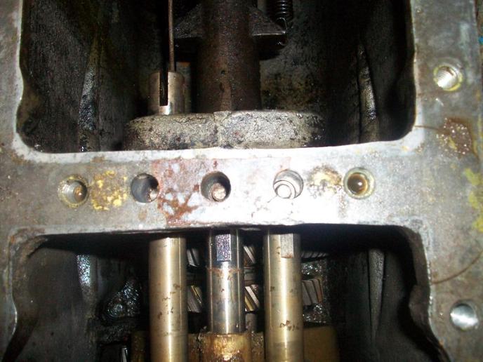

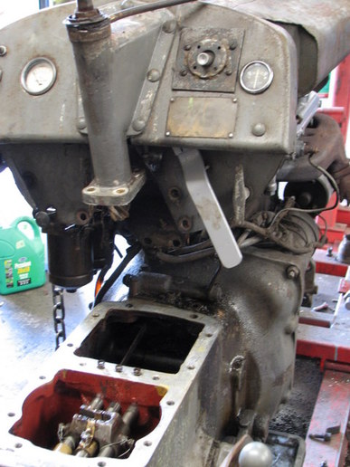

View from top , as it should be .
A less time consuming way of removing the gear box cover .

yes that is exactly what I am looking at except the area where the shifter operates on the slots is much more worn than you pic. also thanks so much for the pics. it looks like I see detent springs on top of trans casting. also it lokks like with any luck the rails may come out without splitting the tractor? thanks again for the pics I now have an idea what to look for.

Unfortunately to remove the rails you will need to split the casing . But by exposing them as in the photo you will be able to lubricate and forcibly move them and perhaps remedy the trouble .

PostPosted: Sun Oct 07, 2018 8:49 pm    Post subject: Re: tea Reply to specific post Reply with quote
Some further that may help .
Shifter rail ends exposed
Indent ball housings

Can't edit the above , I was partially incorrect and you may be able to remove the rail for the 2nd gear selector from the top , I think also the reverse and start can also be removed this way . From memory it is the 3/4 rail that will give difficulty.
Early selectors had a square headed retaining screw holding them firm , if this is the case with yours be wary as it is very easy to round off the head . Ferguson made a special spanner to help prevent this . later boxes had normal hex bolts to do the same job .
