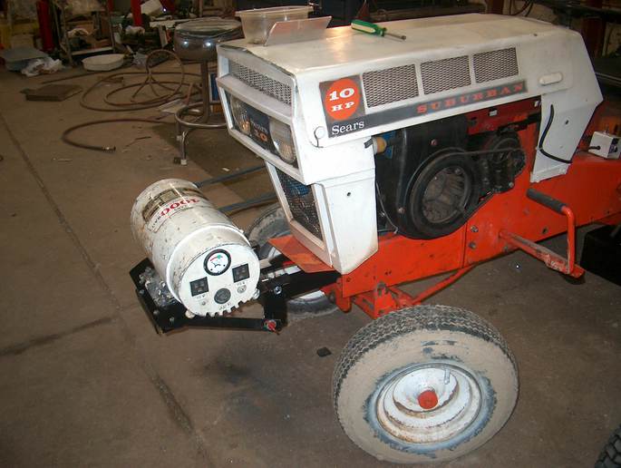

I have a 4000 watt Sears generator made for the Sears Suburbans I've used it a number of times manly with an electric chain saw and it works great very handy

I think such things as an add on generator is beyond what most manufacturers want to put in the marketplace.
I have had one of these add on AC generators on a CJ Jeep and could likely be adapted to most garden tractors if you can get to a shaft or pulley for a v-belt.
The power unit looks exactly like and is the same size as the starter generator on vintage Cub Cadet garden tractors.
http://www.fabcopower.com/generat/bgen.htm

Yes, I had a IH Cub Cadet brochure decades ago of other manufacturer's equipment approved to use on Cub Cadets. Those Pincor generators were in there, along with a couple other brands.
I doubt your local Cub Cadet dealer could get a generator for your 40 year old Cub Cadet now days, but the generators or alternators are available from Northern Tool and it would be simple to make a quick-attach mount for the front of your 128 and run it with a v-belt from the pto clutch. You would have to match the pulley size to the pto clutch pulley size, most generators run 3600 rpm, same as your CC's engine. Might be easiest to start with a spare mower deck mule drive bracket.
