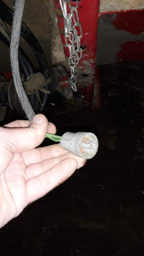

So really scratching my head. I have a 1986 IH 1660 combine. I am looking to by a good 1020 head for it but worried about getting something that doesn't match the HHC on my combine. One problem is that the connecting plug on the combine has been replaced with a flat four wire trailer plug. On the replacement plug only the three female connections are wired, the single male connection was left dangling. There are three green wires going to the trailer plug. Now if that were all there were to it, no problem, but of the three heads available two of them were on 1400 series combines and I am concerned they might have been retrofitted to what the combine had (or would it be the other way around?). The third is about six years newer than the combine. Of the two that were on 1400 series, one of them the seller says has no electrical connection. He adjusts "valves" to get AHHC set. All three heads are 100 miles away give or take and all in different directions. Is there anything I can ask these sellers that would confirm for me that they have the correct unit for my combine? The only thing I know for sure is I have three green wires going to a Jerry-rigged plug. Any help or guidance appreciated!

Just sold a 1020-25'head used on 1660 and 1666.Both combines had 3 prong plug in by hydraulics for 3 wire plug from the mechanical relay potenteiometer. The mechanical links went down and 90 degrees to the shoe follower rod. There is a ht and sensitivity adjustment in cab and some readjust the drop rate of the header lift valve by the step.

If the 1400 series had the electric over hydraulic system it will be the same as your 1660 it wasn't until the 2100 or 2300 series that the potentiometer was changed to a different one, which is easy to change back just cost money, but still used the same plug. The very first 1400 series used a cable to move the hydraulic valve since it didn't have electric controls if the head was set up this way then you would need to do some changing.

Yeah, I have Darrell who helps me a lot. His advice has great value. I especially like it when he gets exasperated with me and tells me to just dig into it and I will figure it out. Always right.
Unfortunately, when you are dealing with auction equipment, if there is a seller still alive he is not likely to know how to send a photo. Only one of the four I am looking at was able to get me a picture. I am having trouble getting them to just FIND the connections. Really a trial. Here is the one picture I could get. This header sold last night for an unbelievable price. UNFORTUNATELY, the reality of buying headers is that there is always some guy who bought the combine. Once he has the combine he will pay just about anything for the heads. So I got skunked last night. But this seems to be a typical connection. Same three wires, different plug. CIH is probably the only source for the plug. I'm guessing $1-200 for a $10 part there.

It's on the head there's 12-18 inches of wire from where you plug the head into the combine with the 3 hole plug to where the potentiometer is then from the potentiometer there's a cable or a solid linkage depending on if it was upgraded this cable or linkage then goes down under the head to sense the movement of the cutter bar and in turn sends a signal to the combine telling it to raise or lower
