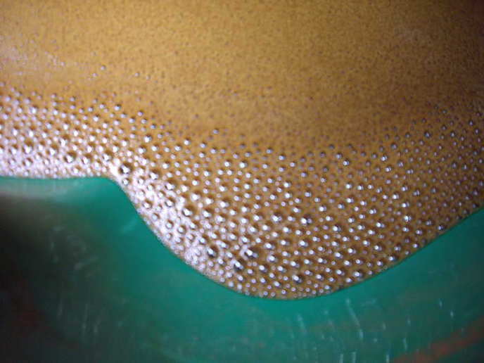

The dirt you have found is really a normal occurrence with tractors that haven't been cleaned out , it never ceases to amaze owners as to just how much is in there . The majority of it is oxide from the inside of the transmission casing , this mixed with moisture from atmospheric condensation creates a gravel like residue that collects at the bottom . Wait until you remove the pto shaft , there is a dead spot adjacent that acts as a trap for a lot of it . I removed an icecream container full from my 1952 TED20 .
The fix is to wash it out with diesel or some other solvent , then change the oil every five years or so . A decent workout will heat the oil and hopefully evaporate any moisture as well .
The pumps are straightforward enough to overhaul , just be aware that there are early versions that used gaskets to seal and later types that used O rings . Later pumps were also fitted with an oscillating plate that helped keep the control valve from sticking , this will most probably be noted in the manual but may not be on yours if it is an early pump .
This is of the nasty stuff that drained out of my 1957 FE35 Shocked
