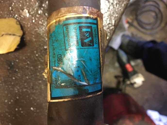

So I have a 1972 Ford 3003 cylinder diesel with power steering I'm attempting to repair the power steering gearbox but I'm having trouble finding parts diagram for the gearbox all of the diagrams that I find more of a style that have separate caps on each side out of the boxes in mine does not have that it has one large one. Someone has already been in this box so I'm trying to make sure everything is present before even attempting to repair my question is has anyone else run in to this type of gearbox and can you help me find a parts diagram.

Sounds to me like you have a 4000, not a 3000. Does your box look like the one in the link below? If not, can you post a
picture of what you have? All 3000 boxes have two caps, one on each side.

definitely not The one in the link mine has two sector shafts ill post pics some time tomorrow as i find time The tractor is definitely a 3000 but there is no telling where this steering gear assembly came from it's been replaced once and gone into once

Do the lines from the power steering pump go to the steering column or directly to the cylinders ? If they go directly to the cylinders then it is an aftermarket power steering system and the steering gearbox is a manual one.

its factory lines go from pump to gear

So the upper bearing is missing all of the ball bearings but I still cannot figure out what type of box this is

close but mine is power steering bit definitely on the right track! Thanks!The bearing I am pointing out in my picture looks like it just has loose ball bearings that should go in there

Here's a power steering gear box with that style side cover:
https://partstore.agriculture.newholland.com/us/parts-search.html?csid=149f14f7bd1a872faabe4952df16fafe&sl=EN&currency=#epc::mr49811ar258922
