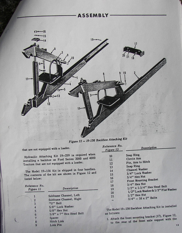

The original subframe was attached with U-bolts to the axle in the rear, and by a crossmember up front. The image below might help you get some ideas for your particular situation.

With a front loader such as a Sherman, from what I can see a few photos of on the web, it's a heavier design, so there ought to be a way to connect a backhoe mount to it. My 850 still has it's 4 pt. mount and it's a flange connection in front of the rear axle, where the loader frame is one end and the backhoe mount is the other. It is a stress point and I am pretty sure I have replaced bolts there at some point. This 713 backhoe is heavy, so the frame needs to be able to deal with the weight and then some. photo is of the mount that I used for a counterweight, worked nice as the lift arms did not have to hold up this weight.
