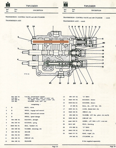

Posted yesterday but can't see it on here anywhere. I have a H60 E Pay loader. Just got it recently ran it for about five and a half hours working it hard. Shut it down for the night next morning started it up barely wanted to move. It has no brakes so I don't think it's the override that some have.
Any ideas on why it won't move now? Fluid is Right level

As I get interested in problems I was nosing around in some old manuals and found a parts book for the H50B,there may not be a lot of difference in things like the transmission control valve,once I seen the drawing I remembered how the nudge pedal works,when the left pedal is pressed air is sent to the control valve and it moves the spool to the neutral position and then applies the brake in other words you drive up to a truck and need to stop and tip the bucket so its left foot on the pedal and you can keep the other foot on the throttle to keep the RPM up while you tip the bucket and put the machine in reverse,you will see in the attached parts that spool valve its the one I marked with the brown bar,that valve should be back to the right in the drawing by spring pressure when drive is engaged,if it was stuck forward there would be no drive,check its operation.
AJ

Yes even though we have no air going to to the brakes cuz we have no brakes we checked that anyway to make sure that the spool was where it was supposed to be and it is not the issue
