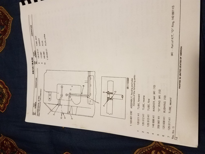

We are going to test the pressures on the lube tubes going to the clutch packs next. We kind of feel like that is the last simple solution that it could be. although if it is a problem with the lube tubes within the transmission, it might not be that simple?

Maybe post that transmission number over at Red Power.
Seems unlikely to me that IH would have built one just especially for that model.
So might have used it in a dozer or something else as well

Okay we took the control valve apart again and there was trash in it. We cleaned it out and put it back on. We had 250 lb of pressure at the control control valve before we clean the trash out of it. Now we only have 150 lb of pressure at the control valve and we know it is clean and working properly now. We took the pump off a couple of weeks ago everything look good and clean inside of it. These pressures are when tractor is in neutral.

The 150psi I would guess may be a teeny bit low but should be plenty to give you drive,the pressure in neutral is created to charge the torque and push the oil through the cooler and filter it also should be enough to engage the clutches when selected and give you drive,see what reading you get from the clutches,if the clutches read good which I think they will because all could not fail at once,the IH boys I am surprised no one has come across a similar problem.

let's just start over on my last post completely. Prior to finding the trash in the sequencing valve throttle valve control valve pressure the control valve pressure was 250. After clearing the throttle valve the sequencing valve pressure was 220 lb. This while this was reading while the gear was in neutral. When we shifted the first gear or second gear the control valve pressure drop down to 130 to 150 lb and would not rise back up. The operator manual or the shop manual calls for a clutch activation pressure of between 270 and 300 lb. There's a 100 lb pressure drop between the transmission filter and the control valve which there's only a 3 ft length of hose in between the two. That's why we think there's excessive flow to the control valve. I have been using sequence and valve and control valve interchangeably in this conversation. One correction there's about a foot-and-a-half of large-diameter hose in addition to the three foot of hose between the filter and the control valve pressure gauge.
