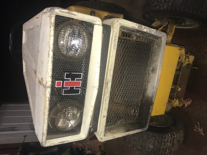

Is anyone familiar with these taillight assemblies on a Cub Cadet (1970s IH built ) 1450? Mine are missing the bulbs, lenses, and who knows what else. Just trying to fix this one up on a budget ajsnwanting to keep original if possible.
For the front light....it is being held in with scrap electrical wire. What holds it in the screen wire? Just the rubber gasket? How to fix?
Needing help to know if the assemblies are broken and if any partsbare kissing other than bulbs and lenses. Also need to know where to find used parts.

As to the tailights, they are just basic red truck clearance lites.
If they have to be 100% original I can't help you, but if "close" is good enough, stop at an auto parts store that has a tailite dispay and have a look.

" What holds it in the screen wire? Just the rubber gasket? How to fix? "
Yes the rubber ring holds the light in the screen. Cut the wire holding the light on the left, remove the rubber from the light. You should see a ring cut around the rubber , pull the front of the rubber through the wire screen as the light on the right and then push the light in the rubber from behind. Note most of these have a reference notch in the rubber that matches with a boss on the light , this keeps the light / lens in the proper orientation and from spinning in the rubber. A little lubricant on the rubber will aid in installing the light into the rubber.

The headlights are held in by #IH-107333-C2 Mounting Ring. You can still find these on the internet.
The Tail Light Assembly (IH-545616-R1) is NLA from Cub Cadet. However, the 1895 Lamp is available in any Auto Parts Store.
The lens (IH-55187-C1) is available from: https://www.ccspecialties.org/electrical.html
As stated prior, IF you are not concerned about being OEM correct, many Truck "clearance lights" will fit in there.

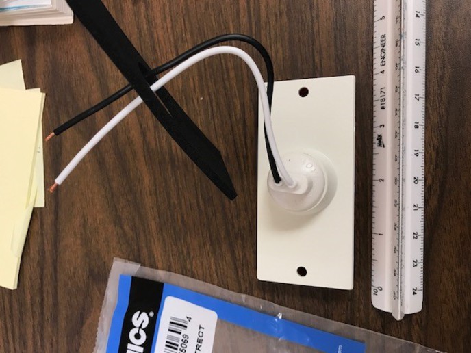

Wanted to share what I found today. I found some universal marker lights that should resemble the OEM lights close enough and should work well. Hoping the bolt pattern lines up but if not it isn't a big deal to bondo a hole and drill another. Have a look at these.....they look close to a factory look without looking too gaudy or "not original looking" like the rounded ones.

Thanks for the tip. Actually this model 1450 original came with tail lights from the factory so the wires are already there!

The 1450 was part of IH/Cub Cadet's "Quietline" series. Within that series, the following models had rear reflectors and no lighting.
* 800
* 1000
* 1200
* 1250
The following models had lighting as standard equipment:
* 1450
* 1650
