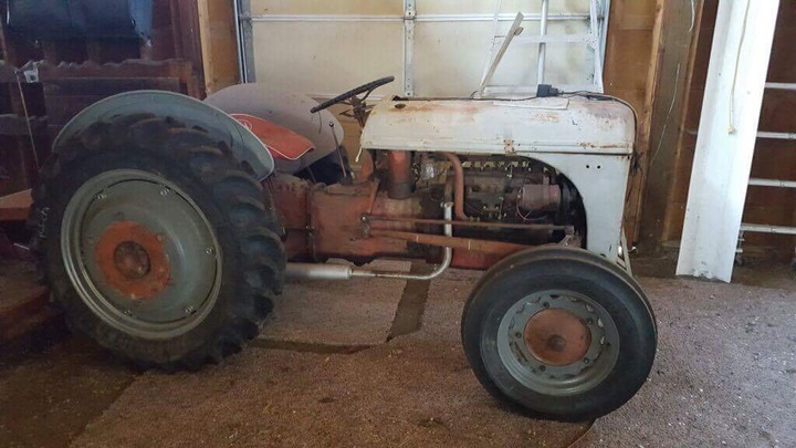

This machine was advertised for sale:
Please note right and left wheel and Tire assembly:
Bob...Owner 2N ford and other colored tires:
