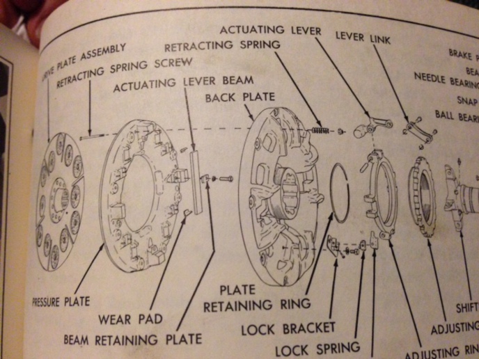

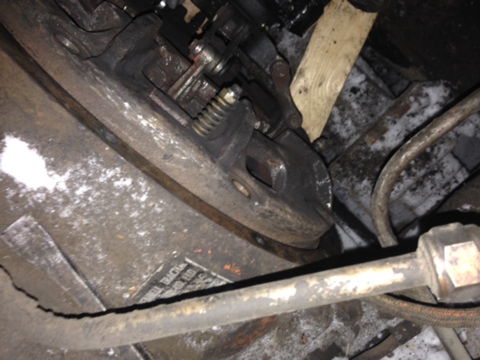

When I have removed clutch pressure plates on regular trucks, I back off each bolt a 1/2 turn in a repeating star pattern so tension slowly releases. I did this and pressure plate did not come off. See photo. It wasn't until we pried pressure plate off with two opposing pry bars that pressure plate popped off. I been reading service manual and still trying to figure out how pressure plate assembly functions to put pressure on clutch disc. Heading out to shop today to see how it exerts pressure.
What part of clutch system causes the "over center snap" when moving hand clutch lever?

"What part of clutch system causes the "over center snap" when moving hand clutch lever?"
The little "dogbone" linkages between the TO bearing and the pressure plate "overcenter" and create the "snap action".
The "toothed wheel" is the clutch adjustment, moving the pressure plate closer to the flywheel to compensate for wear, and keep the clutch snapping engaged properly.

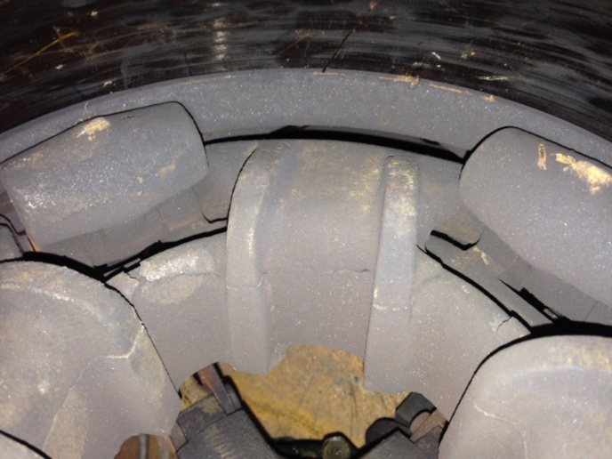

Thanks guys. After being out to shop today I took some photos:
Here is one photo of flywheel wear and tear.
2nd photo: I flipped pressure plate over and seen these cracks in pressure plate mechanism. As the pressure plate sits on work bench its is disengaged. I'm thinking as it is engaged these cracks are causing pressure plate to not fully grip clutch disc. Going to take it apart and see how it works.

I took clutch pressure plate assembly apart and Back Plate is cracked. There is a casting number on it CL-8303. I have a clutch place I can call in Vancouver BC, yet does anyone here know where I could find a good used back plate? I'm thinking it could be welded yet I'm thinking its a part that is under tension when clutch is engaged. Neighbor could only adjust hand clutch lever to 15 pounds on his spring scale so I'm thinking the Back Plate cracks were definitely part of the problem.
