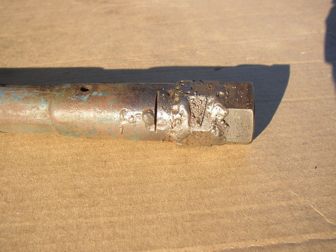

When you'd think, I would be running out of problems, I just have to look at something else, to find out that's not true!
Which do you think came first, the saw cut, or the nuts? The threads on the screw aren't the best either.

PostPosted: Mon Jan 07, 2019 4:24 pm    Post subject: Re: Another part, another problem! Reply to specific post Reply with quote
True, but dang, need to run out of things to fix. It's not like I'm driving it, and finding them, I just pick up something and find them.
The guy that owned it, wore out things, and what he didn't wear out, he screwed up, what was left he abused. But! I will get it all fixed & repainted! I wonder if I should look at the link arms.........before I look into the tranny, or brakes, hmmm.

PostPosted: Mon Jan 07, 2019 7:41 pm    Post subject: Re: Another part, another problem! Reply to specific post Reply with quote
On the bright side, it still works! Smile
Replacement lower sections are available if needed, though not
cheap. I think the upper threaded portion is available too, but not
the entire original adjuster as a unit.

PostPosted: Mon Jan 07, 2019 8:08 pm    Post subject: Re: Another part, another problem! Reply to specific post Reply with quote
The whole assembly can be bought of this site.

PostPosted: Mon Jan 07, 2019 8:23 pm    Post subject: Re: Another part, another problem! Reply to specific post Reply with quote
"The whole assembly can be bought of this site."
I've seen the aftermarket ones and parts for the originals.
I haven't seen one like the original. Sure would be nice if they are!
I've spent hours repairing and straightening some of them for N's.
Now I'll have to go look again... Smile

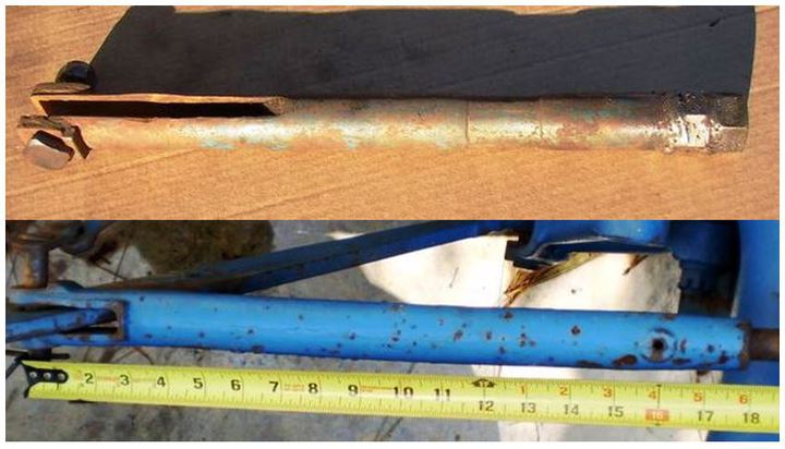

PostPosted: Tue Jan 08, 2019 1:53 am    Post subject: Re: Another part, another problem! Reply to specific post Reply with quote
Pat, not sure if you're really attached to this particular cobbled up lift link but it is an aftermarket replacement. Totally your call but I wouldn't waste my time trying to fix it.
An original looks like the lower pix. Note: The one shown is for a RC but other than length it's will have the same appearance as those used on AP models.

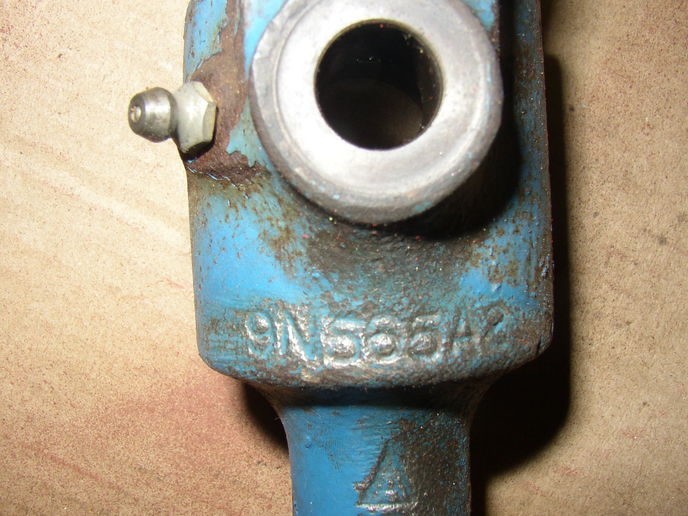

PostPosted: Tue Jan 08, 2019 4:36 pm    Post subject: Re: Another part, another problem! Reply to specific post Reply with quote
So you don't think it's a Ford part?
Today I measured it, and it's 16" long.
I took the head apart, and cleaned it.
The screw head has "9N665A2" casted on it, I think that what is, it's hard to read if the first "6" is a 6,5, or a 8.
Thanks, Pat

Report to Moderator
PostPosted: Tue Jan 08, 2019 4:38 pm    Post subject: Re: Another part, another problem! Reply to specific post Reply with quote
Now that I look at the picture, I believe it's a 5, and not a 6.

PostPosted: Wed Jan 09, 2019 2:32 am    Post subject: Re: Another part, another problem! Reply to specific post Reply with quote
Pat, the yoke is not original but the leveling box is all Henry. Judging from the length of your yoke, you have an AP tractor and the original yoke PN is NCA585B. I recently saw one on eBay for $15.00
