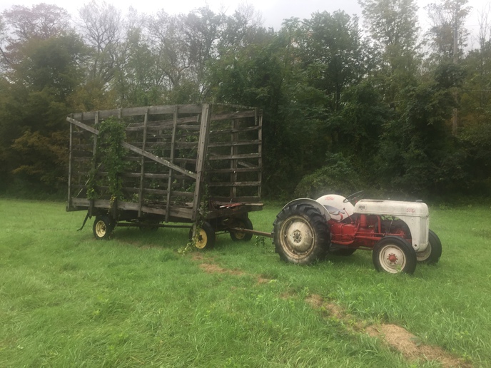

For the next several years I intend to collect my firewood from a 5-acre oak copse on the back of my property, and I keep wiping out the fiberglass fender extensions on my dually on the leaning trees. I am getting tired of fixing them, so I guess I really need to buy a farm wagon to tow behind my 8N rather than using the dually to collect firewood. I can't seem to find any used farm wagons, so I'm probably going to have to buy one new. Would any of you know of one that is a good value? Thanks a lot.

I coutinually watch Craigslist and want ads for bare running gear for a wagon. I have bought 5 in the past few years for about $200 each and we still have 4. On one we built a 12' hayride wagon and my son now has that.
A second one has a simple flatbed and currently has my 6 & 1/2 foot pickup camper on it to move it around easliy. Last year I had both the camper and my golf cart on the 12' bed and pushed it into the barn for the winter.
The third one has a 12' bed on it and currently resides in my 24' trailer. I haul this wagon to tractor show flea markets and roll the wagon out to display my wares. A winch pulls it back into the trailer.The golf cart that could not get into the barn is also in the trailer. When I need to move the camper, the golf cart easily handles the task.
The fourth wagon is still bare framed. I have the wheels off of it to be sand blasted and painted. I found 4 white wall tires that will fit it. I'm not sure just what I will do with it yet.
Just for fun one day I hooked 3 together and pulled them around the field with the golf cart.
I still look for wagons. LOL

At 14 I used to pull two grain wagons behind the '51 8N, with 3,000 pounds of grain in each about 10 miles and
could get into step up 4 gear along the way. I had to be careful going down a hill, fortunately, only
one relativly low one. Second wagon might sway a bit.
Brake pedal locks would have been nice for road gear. I got caught short at a traffic light in town in
high gear. The light changed. The left wheel was all I had to stop all this stuff. I drug that tire
for about 100 feet.
