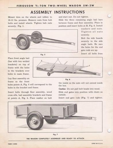

I'd love to find one of the old Ferguson SW-2W 3/4 ton utility wagons but as I've never seen one in any condition around hereabouts, I'm not holding out a lot of hope. I may eventually end up fabricating one from scratch, as it looks like a very versatile rig and just the right size for what I'd like to have.
