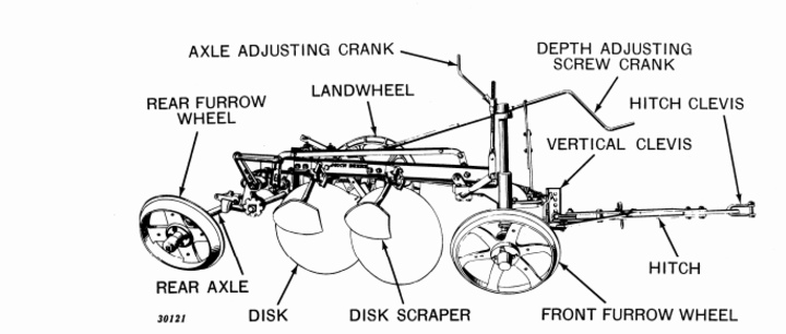

To plow root infested ground you'll have less headaches if you utilize a disk breaking plow similar to photo in lieu of a moldboard plow. Disk breaking plows were built in either pull & 3 pt types

Thanks for the reply Tx Jim. I have only seen disk plows online in videos never for sale in my area (Illinois). If I can pick one up in my area before things dry up this spring I will give it a try. I read a little online and a disk plow would be great for rocky areas and removing roots. I don't have rocks but I have plenty of roots. If I can't find one I will have to use the plow I have.
