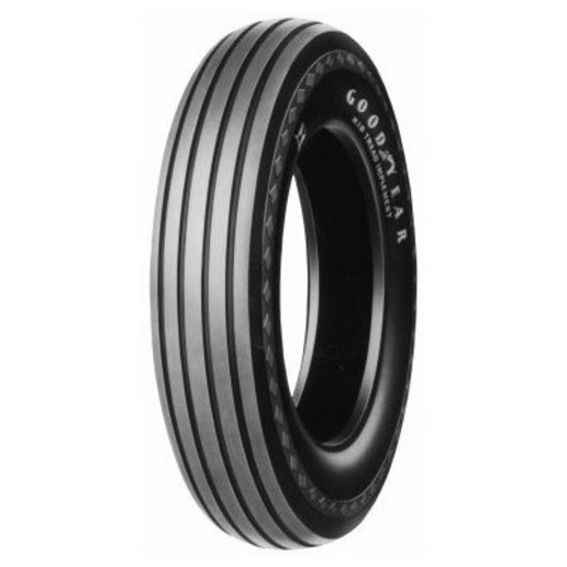

"I'm still having issues with the front tires digging into the grass or stone..."
that's a feature of 3-rib tires - replace them with a 'rib implement' tire or similar and you'll find the tractor friendlier to turf and gravel -

I had the same problem 15 years ago and went with the implement tire. They suit my purposes MUCH better than 3-rib. Much less damage to yard when mowing.

PostPosted: Sat Jan 12, 2019 1:43 pm    Post subject: Re: How hard is it to change out front spindle bearings? Reply to specific post Reply with quote
wish I would have known that BEFORE I put brand new three rib tires on it... how much are the tires u pictured?
Thanks... now I’ll be spending more money on it.. lol
