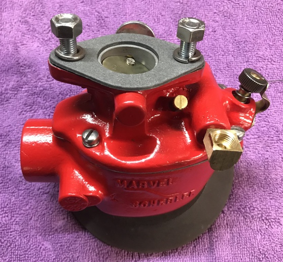

This is one of the many TSX-33's I've rebuilt.

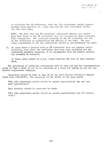

Here's the answer to your question about which carbs were used
when. I searched my docs for this service bulletin and could not
locate it quickly, so I had to use the "phone a friend" option.
Thanks Gary! Smile
Note that the service bulletin says the difference is in the venting
and the specific instructions on how the two should be adjusted is
different. It also says the 8N carb, a.k.a 241 should be replaced if
it cannot be adjusted appropriately. I don't believe they need to
be replaced, nor do they need to be adjusted much differently
today. Use the complete or comprehensive kit and adjust it per
the operators manual. Start at 1 and 1/2 out on the main adjuster
and 1/2 turn out on the idle air adjuster.
Did you know you were supposed to tighten the screws in a
specific order? It was recommended on many car carbs too.
If these aren't clear enough to read, I can email them to you.
