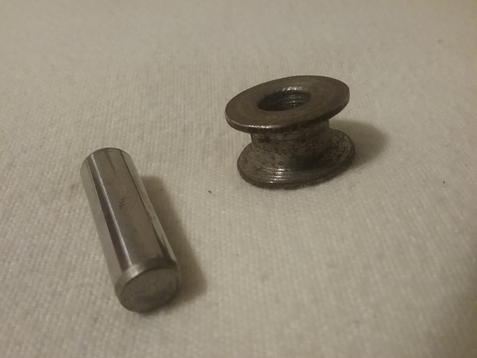

Turned out to be an easy fix!! I had visions of pulling the top cover to find the problem, and am glad I didn't have to. Though I will eventually do it as I have another cover with straight arms and a reformed (welded) cam and I want to try Zane's cam follower pin with the roller. Another time!!
Thank goodness - I was worried i was about to be named as culprit ????
TOH
PS> I would love seeing a picture of the roller pin...

That pin is not exactly rocket science. I was expecting a needle roller bearing.
TOH

Looks like the idea is the roller is held captive on the cam by the flanged sides. Might be problematic if the cam is badly worn. That said if the cam is in reasonably good shape it probably works as advertised. I think if it were me I'd make the roller captive on the pin as in a traditional cam follower design - less dependent on the cam profile.
TOH

mbramble wrote:
I wish I knew of someone who had installed it...
This may be a ready made replacement?
Motion Industries
Koyo NRB CRHSBC-8-1 Cam Follower - Sealed
Roller Dia: 0.5000 in
Roller Width: 0.3750 in
Stud Dia: 0.2500 in
Stud Length: 0.6250 in
I only searched for about 5 mins and came up with this - Longer search may produce closer specs.

That's the general idea. For this application it doesn't have to be that heavy duty.
TOH
