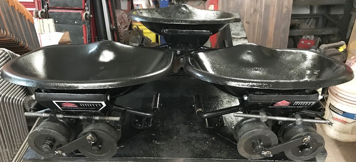

I didn't think I'd be able to salvage all three, but I did.
The third one, in the back, is waiting on springs. They're on back order.
Anyone want to buy a very expensive seat?
I'd love to sell one of these for "only" what parts cost for the three! LOL

Thanks Bill, but I don't think that would be an endeavor most
people would want to pay for. As you know, they're a lot of work.
I see "rebuilt" ones advertised for sale for $350 each.
They look to have bare metal bars, new bushings and new springs.
The seat pan, frame, etc are all still in their original condition.
If I could bring myself to do that kind of work, I might make
money at it but I like to sleep at night. Cool

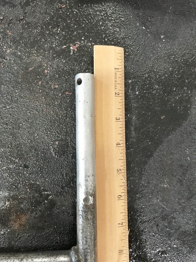

These were the worst set of bars. Not only were they bent, but
this is the set that a previous owner had welded together.
I put them in the press and straightened them, then found out
that they were also twisted. That was a bit more challenging but
I got them all straightened out, welded them up and ground them
down just like I had to do with the rest of them. Time consuming.

Royce, nice job on the seats. I have three of them that I will have to repair someday. How difficult are the seats to disassemble?

Disassembly depends upon condition.
Properly overhauling a R-O-R seat is a time consuming process. The first will take about twice as long as the second and third, all else equal.

I have to agree with everything Dean said.
One of these had been welded together. It was a pain to get apart.
The other two weren't so bad, a few roll pins and two bolts.
The roll pins can be a bear to get out at times.

I've done 6 over the last 2 years, agree, very time consuming and can be frustrating at times. I sourced the bushings and springs from Korves Oliver parts. Oliver's seats seem to use the same parts. Just like Royse, I had to weld up all the worn h-bars, straighten some , and then take the twist out of some.
It is a winter project for me and based on how bad the seat was worn, very time consuming. Worst part for me is getting the torsion springs off the h-bars. Usually takes some heat, Gibbs penetrating oil and the shop press.]
