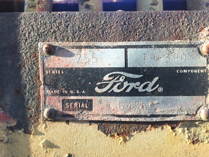

The backhoe is a model 755. I still haven’t found the where the hydraulic filter is or where to check. The only plug that I found was on the rear axle right hand side. Where ever the tractor was was leaking hydraulic fluid, the person pumped the fluid back into the transmission. I ordered the fuel filter housing for the tractor today.

Backhoe model.

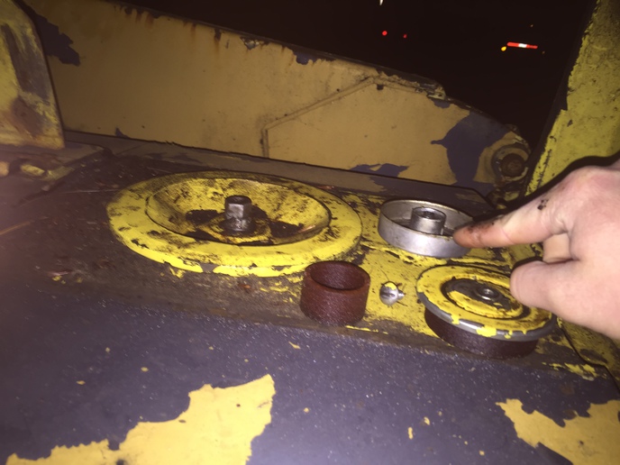

PostPosted: Mon Jan 14, 2019 7:21 pm    Post subject: Re: Ford 4500 Reply to specific post Reply with quote
CVPost-JF in MI wrote:
(quoted from post at 15:14:59 01/14/19) If you open the hood (engine cover half) which covers a tab of the hydraulic access cover door (in front of the radiator), lift and tilt the door/cover forward. Everything is
under the cover.
Thank you, found the cover. I take it where the finger is pointing to is the filters and the nut on the left is where you fill it? If so, if I was to take it off, it would show the level (no dipstick, but a line on the side of the tank.
Nope, you've got them backwards. The smaller round cap that you took apart is the breather and dipstick. You should have just pulled it out rather than taking it apart. The other nut with the larger circle around it is where the filter is located. Here's a link to the parts diagram. group of parts labelled 83 is the breather and indicator (dipstick) and the parts labelled 75 is the filter housing, and 72 is the actual filter:
4500 hydraulic system parts diagram

PostPosted: Tue Jan 15, 2019 1:22 pm    Post subject: Re: Ford 4500 Reply to specific post Reply with quote
How would you fill it? Take out the filter or use the dipstick hole?

PostPosted: Tue Jan 15, 2019 4:50 pm    Post subject: Re: Ford 4500 Reply to specific post Reply with quote
Dipstick hole and funnel.
