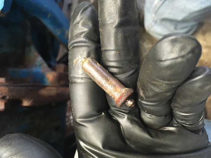

Drill a hole in the sender bulb that is stuck in the head screw a large metal screw in the hole and pull it out with a claw hammer.

So does the temp sender screw into the head or does it just stick in there?

Providing that you removed the threaded bushing that I told you about, it is just sitting there waiting for you to poke it with a screw driver as I told you.

it's just rusted in there.

Sprayed it a few days back with penetrant until I could get back out to work on it. Bumped it with a screw driver and pulled it right out. Thanks for the tip!
