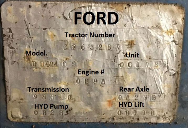

Hi I am just getting a 1970 Ford 4000 tractor which I believe has a gas engine. Any other info from these numbers that are still very clear on the foil tag under hood
Serial is C263287 model is D. 1424. CS. Wonder what this means? Engine is 9M31B. Any info would be greatly appreciated

C263287 is a 1970 serial number.
Model number D1424CS:
D14 at the beginning says that it is a 4000SU (SU means "Special Utility"). The 4000SU is also referred to as a 4140 in the parts book. The 4000SU had the 201 ci engine of a 4000 series and the double reduction rear axle with inboard wet brakes form the 4000 series, but it had the the radius rod front axle and double sided steering linkage like the 2000/3000 series.
The 2 means that is has a gasoline engine.
The second 4 says that it has independent 540 rpm PTO.
The C says that it has an 8 speed transmission.
I am not sure what the trailing "S" means.
Engine number 9M31B means that the engine was assembled on December 21 1969.

CVPost-Bern wrote:
(quoted from post at 23:20:13 01/20/19) 9M31B would be a New Year's Eve tractor, not a winter solstice tractor. Smile
Bern, he said that 9M31B was the engine number, not the Unit number. Hard to tell from that small picture of the tag, but it looks like the unit number is 0C30B which would make it a March 30 1970 Day shift tractor.

PostPosted: Mon Jan 21, 2019 6:13 am    Post subject: Re: 1970 Ford 4000 Reply to specific post Reply with quote
i was able to work on the picture of the foil tag, i was not sure if you could zoom on this site when i first posted it, the numbers are very clear still on the tag.

PostPosted: Mon Jan 21, 2019 7:26 am    Post subject: Re: 1970 Ford 4000 Reply to specific post Reply with quote
OK, I can see the Unit number clearly on that new picture. 0C17B is March 17 1970 day shift.

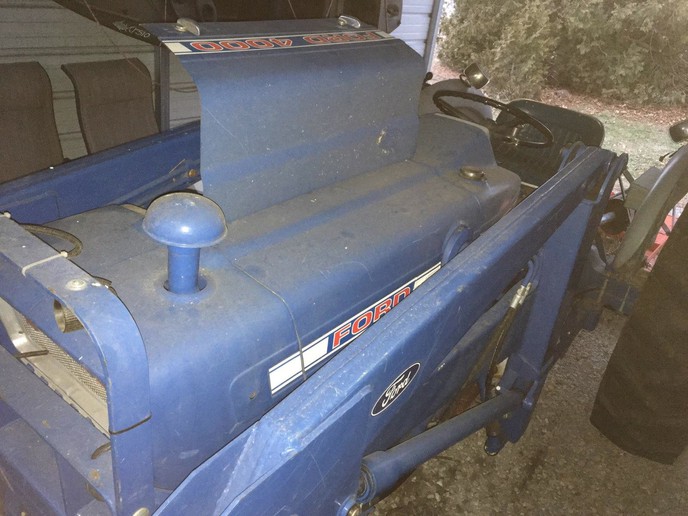

PostPosted: Mon Jan 21, 2019 9:05 pm    Post subject: Re: 1970 Ford 4000 Reply to specific post Reply with quote
What's the opinion of vertical muffer compared to this must have some exhaust pipe in nder tractor. Seems like it just get to be a problem under the tractor.

PostPosted: Tue Jan 22, 2019 5:18 am    Post subject: Re: 1970 Ford 4000 Reply to specific post Reply with quote
swattley wrote:
(quoted from post at 01:05:38 01/22/19) What's the opinion of vertical muffer compared to this must have some exhaust pipe in nder tractor. Seems like it just get to be a problem under the tractor.
Depends on what you'll be using the tractor for. Only problem with a horizontal exhaust under the tractor really would be if you plan to mow a lot of tall dry brush where the hot muffler might set something on fire. Vertical muffler is a problem when working under tree branches, so it's a trade-off based on what you want to do.
That tractor has obviously had the horizontal exhaust its whole life, or at least the tractor that had that hood on it when it left the factory has. A vertical exhaust requires a hole in the top of the left side hood panel just forward of the air filter, and tractors that have been converted still have that hole, usually with a plug in it.
