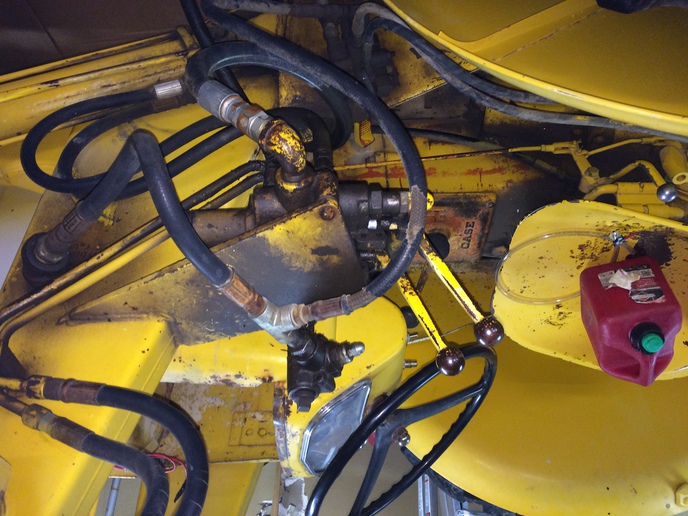

Is it possible to have two hydraulic pumps? I think there's one located in hte normal spot that runs the three point, then one with a lovejoy connection to the front tf the tractor with a filter mounted on top, that pulls fluid from the inner cavities of the loader frame.

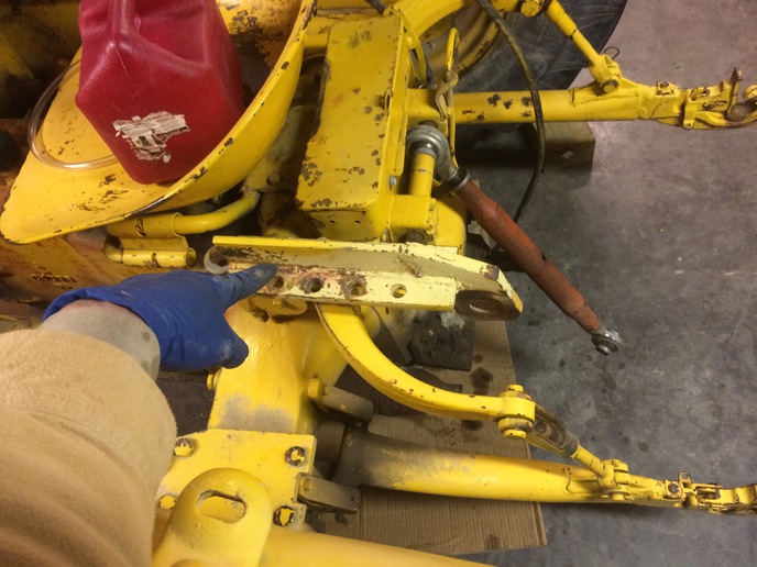

Also, Anybody know what this holy metal bolt on would have been used for? Newer grade 8 bolts, so it wasn't OE.

Front pto hydraulic pump is fairly common on utility tractors mostly used to run a loader and sometime backhoe. Reservoir is one of the upright frames plus the hollow frame that runs back and bolted to the back axle.
My 310 had a long life as a loader tractor, used hard and put up wet. External hydraulic leaks all over. Front Pump had a sock type filter in the suction line that had collapsed. I just pulled the whole mess off, gave the good parts away. Run supply and return lines to the loader controls from the upper control valve interlock to run the loader. The internal pump is capable of lifting as much as the tractor is capable of traveling with.
I don't know what the bracket is for. Normally there would be a bracket right there for hydraulic remotes. Looks like the bracket is attached to the lift arm to move up and down? Maybe a light for field work?

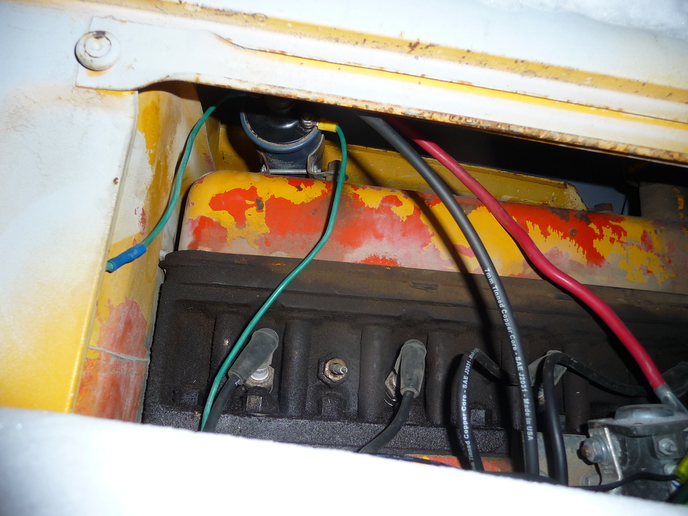

Your tractor has been painted over the original color which shows up on your valve cover and front of the gas tank (your pic above). Some 310 were painted single color for industrial applications but most were 2 tone Flambeau Red body and Desert Sunset sheet metal. Of course it's your tractor paint what ever suits you.
