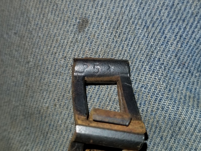

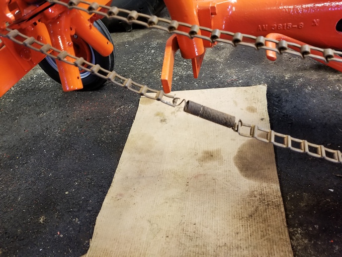

Where do I buy chain for this seder unit I have? I'm about 4 links short of completing the loop. This is the 1" length between links 3/4" wide

Drives (brand name) chain. Wire brush a link on the large portion and you will find a number like 42 or 52 or 62 IIRC and any ag dealer should be able to help you. I worked for a JD dealer and we had a bunch of it with our bulk roller chain. Also Baum Iron will have but probably only in 10' rolls.

you have your chain inside out.if you don't have the tool to break apart or reattach links buy one. where you buy your links should ,have one to use and show you how. the chain is called detachable link chain,

Any family Center, Tractor Supply, most welding shops around here have it. Any Deere, Case IH, New Holland
dealership outta have it.

Nash, probably have some of that if you get me a number off the link.

Arlen....the links have a 25 and star

Shoups has No. 25 Detachable Chain.
