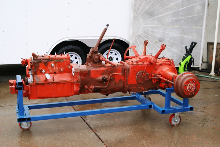

This weekend was pretty productive even with all the rain (I guess it beats the snow that some of you have posted pictures of!)
So this is where it sits. It needs pressure washed one more time and then has to dry and it'll be ready for the epoxy primer and paint. I paint outside so the weather has to cooperate.

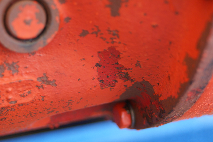

When i originally got the tractor I thought it had severely faded red on it. Now having broke though to what I think is the original color it looks like someone painted it Chevy orange. Poor Ford tractor wearing Chevy paint. Sad

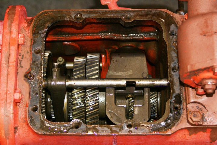

This is what I found when I drained the transmission/rear end/hydraulic fluid out of it. Caramel milkshake! (this was before pressure washing the outside).
Along the way of dis-assembling it I needed to replace the transmission top cover gasket. The gears are in amazing shape for a 68 year old tractor.

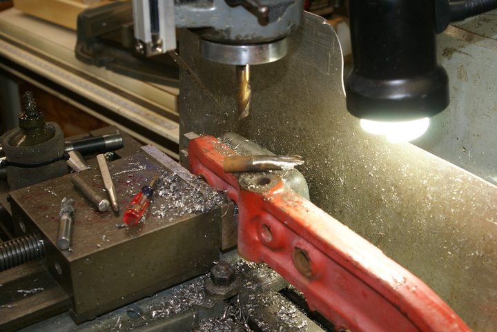

Remember the front axle/radius rod pin I mentioned I couldn't get to move? I tried everything heat, a hydraulic press, pounding on it, and it would not even budge. So I went to the real tools Smile

PostPosted: Sun Mar 03, 2019 4:14 pm    Post subject: Re: My first 8N 1951 SN# *8N356218* Reply to specific post Reply with quote
That red paint is know to turn into a pump'kin Sad...
What paint do you plan to paint with..

PostPosted: Sun Mar 03, 2019 5:07 pm    Post subject: Re: My first 8N 1951 SN# *8N356218* Reply to specific post Reply with quote
Hobo,NC wrote:
(quoted from post at 17:14:23 03/03/19)
It'll get SPI red oxide epoxy primer in an attempt to seal all that "stuff" in and then the top coat will be Kirker Ultra-Glo Urethane Enamel. I've used it a bunch of times and it's gotta be better than the spray can bomb stuff that the last guy did. If you look close in the picture it comes right off with the pressure washer and my pressure washer isn't the biggest and baddest pressure washer.
