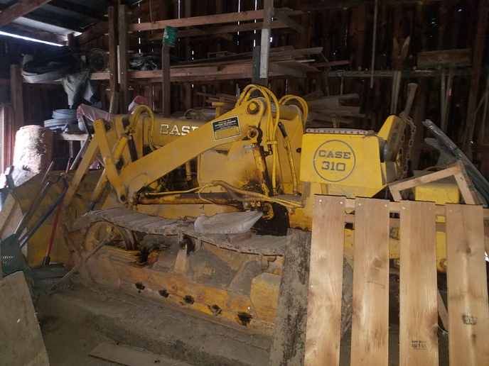

I just bought a 310g and was wondering the best place to buy parts, was told its been sitting for 25 years but overall is in great condition. Probably a once in a lifetime barn find!

That indeed is a good find, looks to be a fresh loader and I see the scarecrow was keeping an eye on it,you will get things like filters at NAPA and there is plenty aftermarket parts available just Google Case aftermarket parts.

Thanks! I put new plugs, points, rotor and cap, good battery and some fresh gas to the carb today and it fired up, throttle linkage is sticky, the carb was pouring out gas and the clutch wont disengage but overall I'm impressed. Trying to hunt down a carb kit now

The needle valve may be stuck open in the carb but if you do need parts have a look at the Carb Shop at the link below, the clutch disc maybe stuck to the flywheel and wont break free when you press the pedal,you may get it to break free by putting it in top gear,hold the brake and clutch pedals down and making sure it is clear all round jab the starter in the hope it will break free,it may take a few try's.

I got it running and driving yesterday, trying to find a radiator for it now, I believe this one is beyond repar.

I have a good radiator out of a case 310. are you close to Missouri. my email is open
