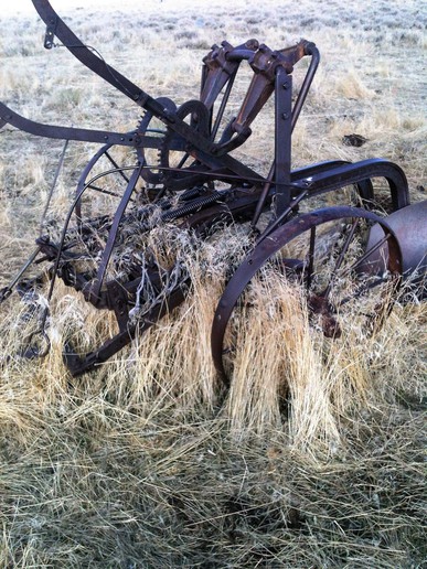

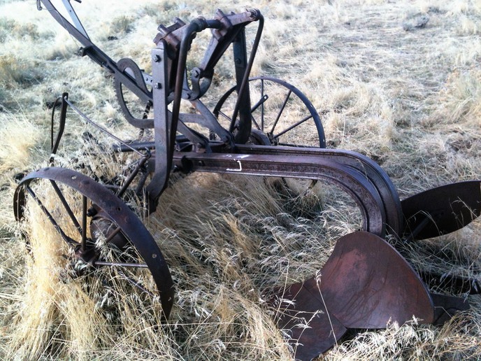

Hello,
I was looking for help with this plows (I think it's a plow) identity. I have been perusing the forums and best I can tell, it is an IHC? If the forum has a space a person can enter the PO numbers, well I missed it. I know nothing about old farm implements so any info would be of great help and much appreciated, ex. age, name, model, value. Thank you in advance for taking a look at the pictures.

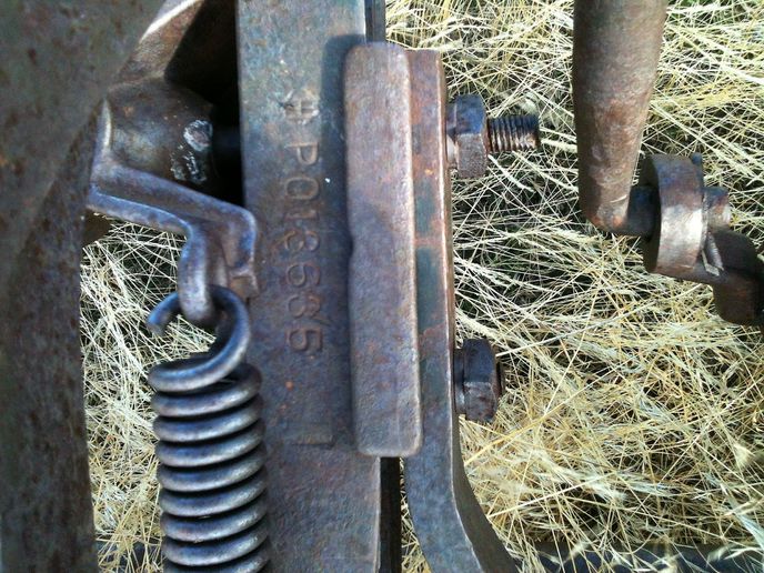

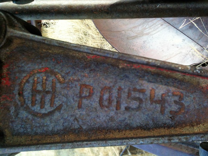

I have pictures of the PO numbers but I am having trouble getting them to load, so I will just list them here....
PO1543
PO13635
Thank you....

You might want to post this on the Farmall board. You've got an early 2 way plow.
Back to top
View user's profile
Farmallb
Tractor Expert
Joined: 01 Jan 2008
Posts: 3035
Report to Moderator
PostPosted: Sun Mar 10, 2019 10:52 am    Post subject: Re: Identification of plow bestowed upon me recently Reply to specific post Reply with quote
Yup its a dang early, Perhaps P&O plow before IHC bought them out. It is a tractor plow and it
looks to be missing the front hitch. These were mostly used on hillsides so as to throw the furrow
up hill, figuring that in the course of the year the dirt would seep back down to hopefully only
where it had started from.

That looks like a McCormick #37 plow. That was International Harvester's first two way plow, followed by the #38 and then the #39. Per my information the #37
came out in 1929. The setting up instructions and owner's manual references measurements and adjustment for the McCormick-Deering 10-20 tractor. Here is a
picture of one. Hopefully I can get it to load. More pictures available.

I am going to try to post the picture with the emblem on it.. maybe this will help us to know more about who made it and it's date of birth. Someone mentioned above about posting it in the Farmall board, but I will have to figure out how to cross post. If it helps, it is located in Wyoming. I am thinking (I know, dangerous right??) whoever mentioned it being a furrow plow, throwing dirt uphill, would be close to right. The ranch was used as a sheep farm many many moons ago. There are no trees, just beautiful rolling hills for miles and miles. They would move the sheep from the upper ranch to the lower ranch (where my plow is located) every year.

PO 1543 is a part number from a McCormick-Deering/IH #37 two way plow. It is a piece that is at the top of the arched shaft near the top of the plow. It is the
larger piece that is on the bottom of the shaft and fastened to the shaft with part number PO1544. There are two of each on the plow, one for the right hand
bottom and one for the left hand bottom. Unfortunately I cannot find it in the parts book. This would be a vintage 1927 to mid 1940's plow where the parts
books did not show a schematic parts breakdown like newer models. Hopefully the pictures will attach and they will help.
