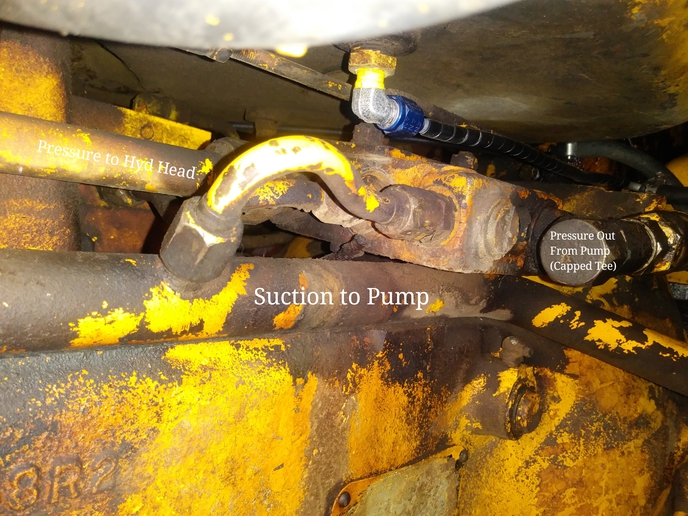

Forgive me for not understanding, but what "TEE" are you talking about? As I understand it, the pipe with the Red Valve on it is typically where an Aux would be tapped in for pressure. ?? Shouldn't the Isolate Valve shut off pressure to the 3 Point and direct it to the Loader? If the system was butchered to allow for the loader installation, what is the proper way to do it? Thanks for any insight.

Thank you for your continued support! In your explanation, you stated that I would need to connect the loader hydraulic control in hose that is connected to the Aux Port to the small high pressure line out of the splitter block. Please see the photo below. Do you mean the small line shaped like a question mark? Reason I ask is it is tapped into the Hyd Pump Suction Line, which I wouldn't think to be High Pressure. Also the loader hydraulic control out hose would have to go to the small hi pressure line at the front of the seat just above the transmission cover. Is that the one directly behind the shifter (shown in the second pic of this thread)? That pipe also goes to the PS Block, which I have labeled below. Forgive me for not understanding... it just doesn't make sense to me as to why both would connected to High Pressure.

PostPosted: Sun Mar 17, 2019 6:25 am    Post subject: Re: No Loader Pressure IH444 Reply to specific post Reply with quote
Hi, not the ? line but remove the "Pressure to Hyd Head" line and connect the Loader valve high pressure In port Hyd line to
here.
Connect the Loader valve Out port to the Hyd In Port on the Hyd Head in front of the seat. This is where the line that you have
labelled "Pressure to Hyd Head" should go. I took your photos and put a blue line around the Hyd lines to connect the Loader
Value into.
Third photo is of a 444 with a similar Loader control valve as yours except it does not have a dump Hyd line going to the fill
plug behind the seat. The blue line is high pressure in from splitter block to In port on loader valve and black line is loader
valve Out port to high pressure In port of Hyd Head in front of seat. In this photo it would appear that the installer just took
the Hyd line off the splitter block and bent it out so that he could connect a hyd hose. Not ideal but it works. Usual method is
to shorten the steel line and put a new Hyd fitting on it or run a Hyd hose directly to the In port of Hyd Head but it is a
little difficult to get the Hyd hose to fit next the trans cover.
Theory, you 444 is an "Open Center" hydraulic system, meaning that the hyd oil is constantly flowing in a loop and when you pull
a control valve it diverts this flow to the hyd cylinder. This system is like an series electrical system. Newer modern tractors
use "Closed Center" Hyd system where there is constant pressure on all valves and the pressure is regulated by the pump. This is
like the water system in your house.
So for your 444 that is the reason you would connect the Splitter Block "Pressure to Hyd Head" port to the In port of Loader
valve and then the Loader valve Out port to the In port of "Hyd Head". The free flowing loop of Hyd oil must be maintained or
damage to the Hyd pump will occur. On the third photo I red circled the relief valve in the loader control valve, this to
protect the pump. If you were to take the loader off the tractor including the loader control valve, you would have to connect
the Hyd hoses from the loader control value In port to the Out port together to maintain the Hyd oil flow loop.
Hope this makes sense to you, if not post more questions.

The TEE I was talking about was the TEE you were going to put in to take pressure, along with the numerous other TEEs that were shown in your pictures.
If done properly, everything should just work. You should not need to do the hokey-pokey with a bunch of valves and have to choose between loader, 3pt, and/or whatever else. How that's done on a 444, I can't tell you because I'm not familiar with that tractor, but it's not impossible. There's no magic to hydraulics.

I never stated anything about installing a "TEE" anywhere, thus my confusion. I was installing a terminating pressure gauge in the Aux port to check for pressure, which would not overload the pump.
