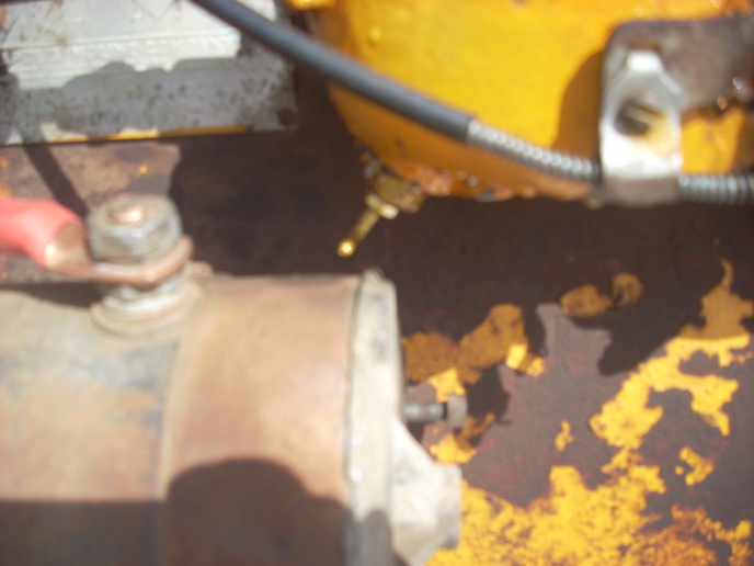

The main jet on the bottom of the carburetor on my 445 is so close to the starter that it actually hits it, making it nearly impossible to adjust it.
I am fairly new to the tractor, and I suspect that the starter is not original, but it doesn't appear any longer than a normal one.
Are all 445's like this? And if so, how do you deal with this?

I think mine is like that. Really close. It looks like the bend in your has been 'straightened' a bit over the years, though.
It might break off if you try to bend it though.
I wonder if the replacement t-bar style needle would have more clearance.

Thanks for the replies. I may have to check with my mechanic whether the other style is available. Right now I can only go a half turn in either direction before it hits the starter. It runs fairly well where it's at, but I'd like to be able to tweak it a little more. Don't want to force it and risk breaking something.

The starter does look like a different one as the 445s had a button style starter switch on the top
which was activated by a pull rod next to the ampli-torque lever. Has the intake / exhaust manifold
been replaced? I had the same problem with mine after I installed a new manifold when I came to put
a carb kit in it. My jet was bent a little so I just bent it a little more to make it work. It is a
working tractor. MM had funny things that way, like having to remove the carburetor on a 5 Star to
remove the starter lol.

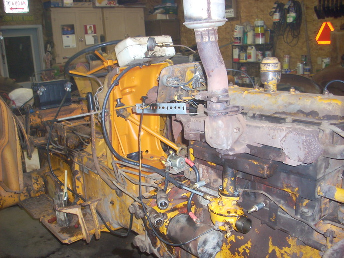

This is the replacement manifold I installed on mine. I believe on the original ones, the intake is
round not square. If you have a picture of the manifold we should be able to tell. I think there is
a small difference in the length on the new ones.

PostPosted: Tue Apr 16, 2019 5:06 am    Post subject: Re: 445 carb question Reply to specific post Reply with quote
Here's what it has. The neck where the carb bolts on does appear to be a little longer than yours. I probably won't replace it as long as it's in decent condition. The tractor is mostly a toy and will not be doing a lot of work. I'll figure out a way around the carb issue.

PostPosted: Wed Apr 17, 2019 7:58 pm    Post subject: Re: 445 carb question Reply to specific post Reply with quote
That is an original manifold. Be sure to check for cracks on each side of the two bolts that hold
the elbow on. Some exhaust manifolds had some strengthening ribs in them some didnt. They usually
crack in that area. I had a hole about the size of a 50 cent piece is why I replaced mine. The
original bottom seat cushion on these had springs in them. It makes for a more comfortable ride than
regular foam. If you arent going to do a lot with it foam will work fine. I bought the spring one
for mine off of ebay for about $68. It is the same style as used on John Deere models of the same
era. I plan on cutting hay with it and do a couple of other jobs with it.

PostPosted: Fri Apr 19, 2019 5:27 am    Post subject: Re: 445 carb question Reply to specific post Reply with quote
It dose look like the 90 degree end on the adjusting needle might be bent down a little. Other wise just take a die grinder and shave a tad off the starter where it hits.
